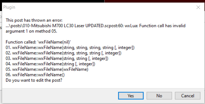

Thanks Les! The full file path works fine. However, these two throws an error:
local fileName = wx.wxFileName(path):GetName()
local fileName = wx.wxFileName(path):GetFullName()
Did you call sc.Parts:Get():GetFileName() first? For example:
local path = sc.Parts:Get():GetFileName()
Yep, here’s the section of the post. Its inside the function OnInit()
   rapidX = 0
   rapidY = 0
   postFileName = fileNameOnly
   scamJobPath = sc.Parts:Get():GetFileName()
   scamJobName = wx.wxFileName(path):GetFullName()
   initialized = 0
Try
   scamJobName = wx.wxFileName(scamJobPath ):GetFullName()
Oh i see whats happing now… sorry, i’m such a rookie. That works perfect.
