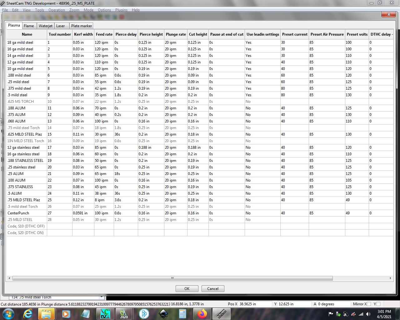

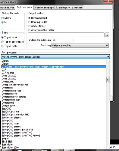

I think I know what you are looking for. It depends on the post processor you use. Some of the basic ones won’t have the settings for DTHC in the tool table. The one I use is the DTHC-HYT-DTHC_ SOftPierce. with this Post processor you get the added setting for torch height.
This is someting i looking for, but how to make the extra colums in the tool table, could you share your postprosessor file so i can see how to add it.
You have to add custom tool settings to the post to have them show up in the table.
But then you have to edit the post to make them.di something. If you look at some of the posts you should see how they are created.
