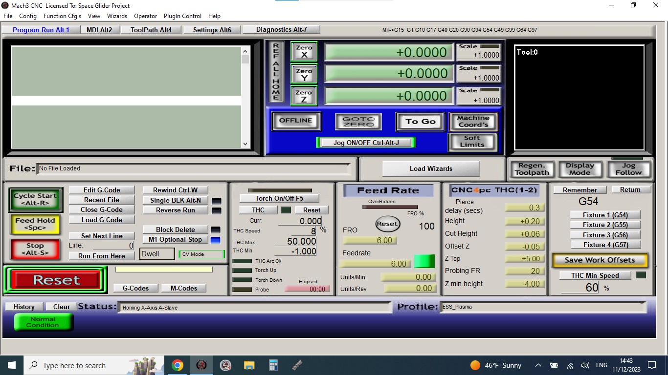

This post is supposed to work with this Mach screen. probe federate and other variables are adjusted on the screen.
Your post has the z moves commented out, but still has a feedrate change (programmed incorrectly as text). The screen is made for the unedited post with a Z axis.
Comment out the feedrate in the onpendown and it should stay at the normal feedrate instead of the probing feedrate (which I assume you had set to 30 when you made your gcode). Whomever modified the post you are using made some mistakes.
Make this change and rerun the post and see what the code looks like.
