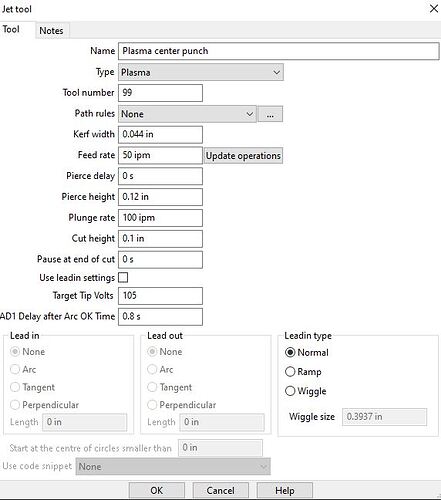

created a new jet tool (attached)

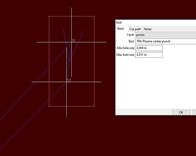

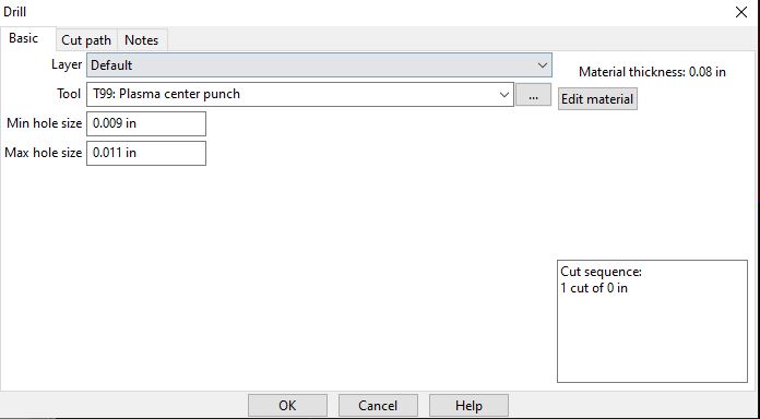

select a drill operation with the new plasma tool (attached)

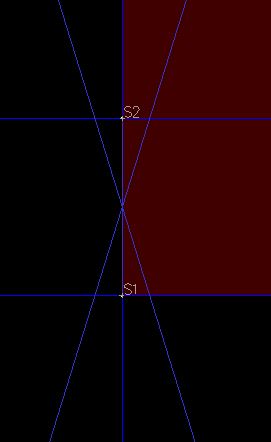

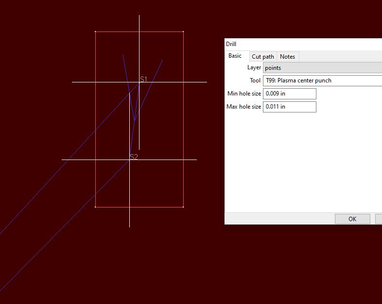

but the 2 points have S1 and S2 with a big X in the middle.(attached)
Where is my mistake and how can I fix it?

pierce delay is 0. Does the torch fire at all ?
pierce hight - cut height is only 0.020", that’s going to be quick.

it appears the problem is that there is no OnDrill() function defined in the .scpost.
I’ll put a basic version of OnDrill() in and see how it goes.
