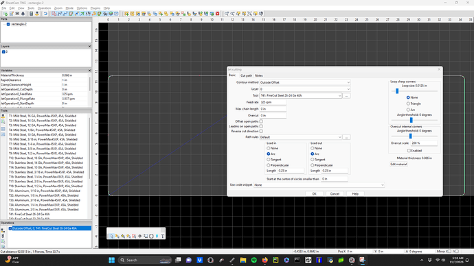

I need help cutting perforated sheet metal. My setup is a Hypertherm Powermax 45XP on a 2x4’ Avid CNC plasma table controlled by Mach4. I realize the answer to my question might be in the mach 4 settings but I thought of asking here as well.

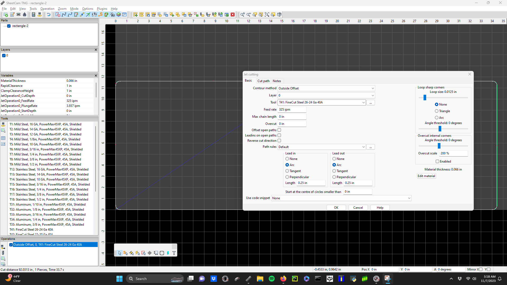

My design is a simple rectangle. The torch drops down, ignites and then stops immediately. Is there some setting (a “rule” or similar)in Sheetcam I need to change? The Hypertherm generator does otherwise work with non-contiguous surface (keeps the flame alive), I have cut mesh before. I use the plasma CNC infrequently and do not have a great understanding of the intricacies of the system, and I don’t remember prior settings.
These are the screen grabs; I am using FineCut for 24Ga

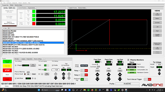

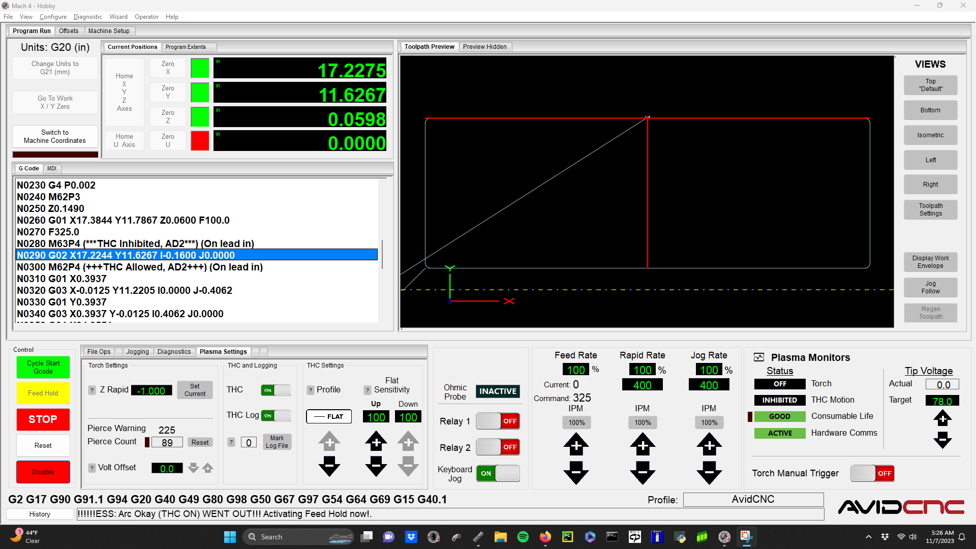

The error message is potentially interesting but don’t know what to change:

I managed to fix the problem with some help from the Avid CNC forum; I reduced the settings from 40A and 78V recommended in the Hypertherm manual to 30A and 60V.

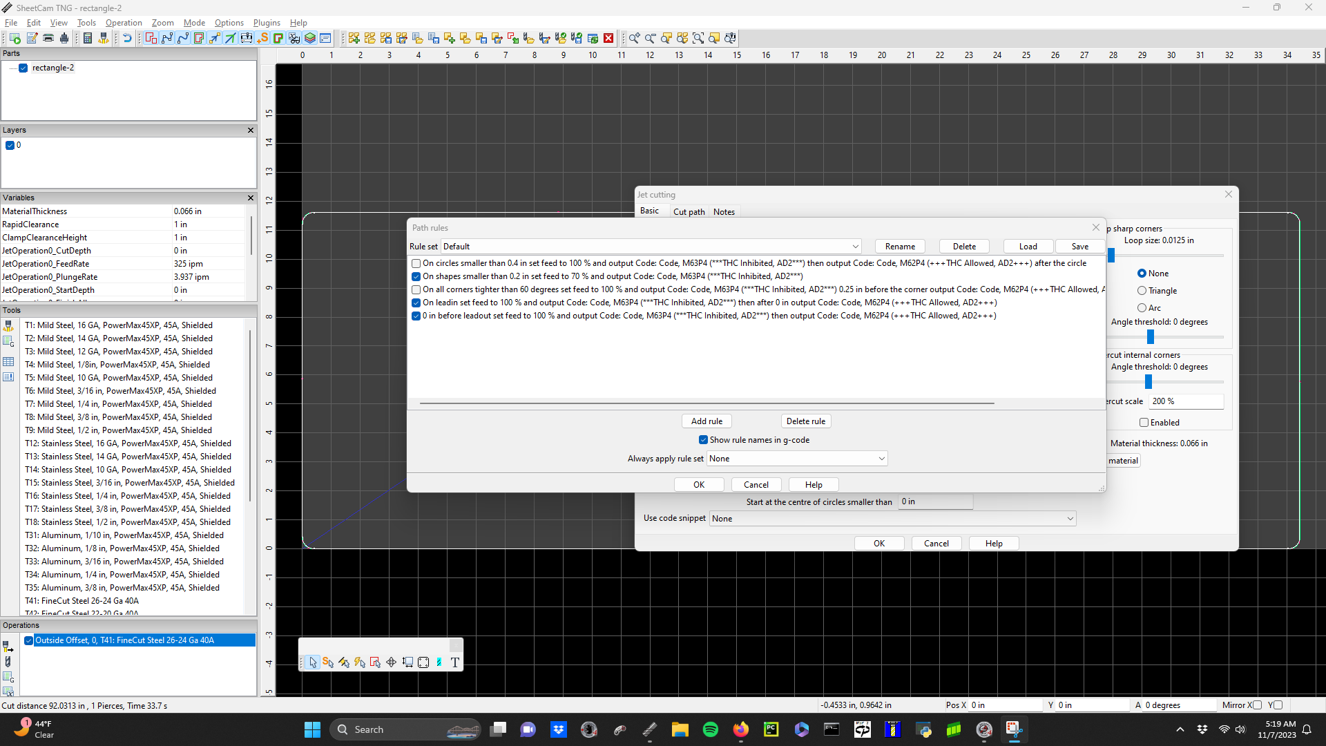

In playing with the sheetcam settings I encountered the settings “AD1 Delay After Arc OK Time” set at 0.8(by default?). What is this parameter; there is no mention in the Sheetcam help.
That must be something that your controller uses. It’s not a normal SheetCam setting. If you look through the gcode, it’s probably being sent to the controller.
