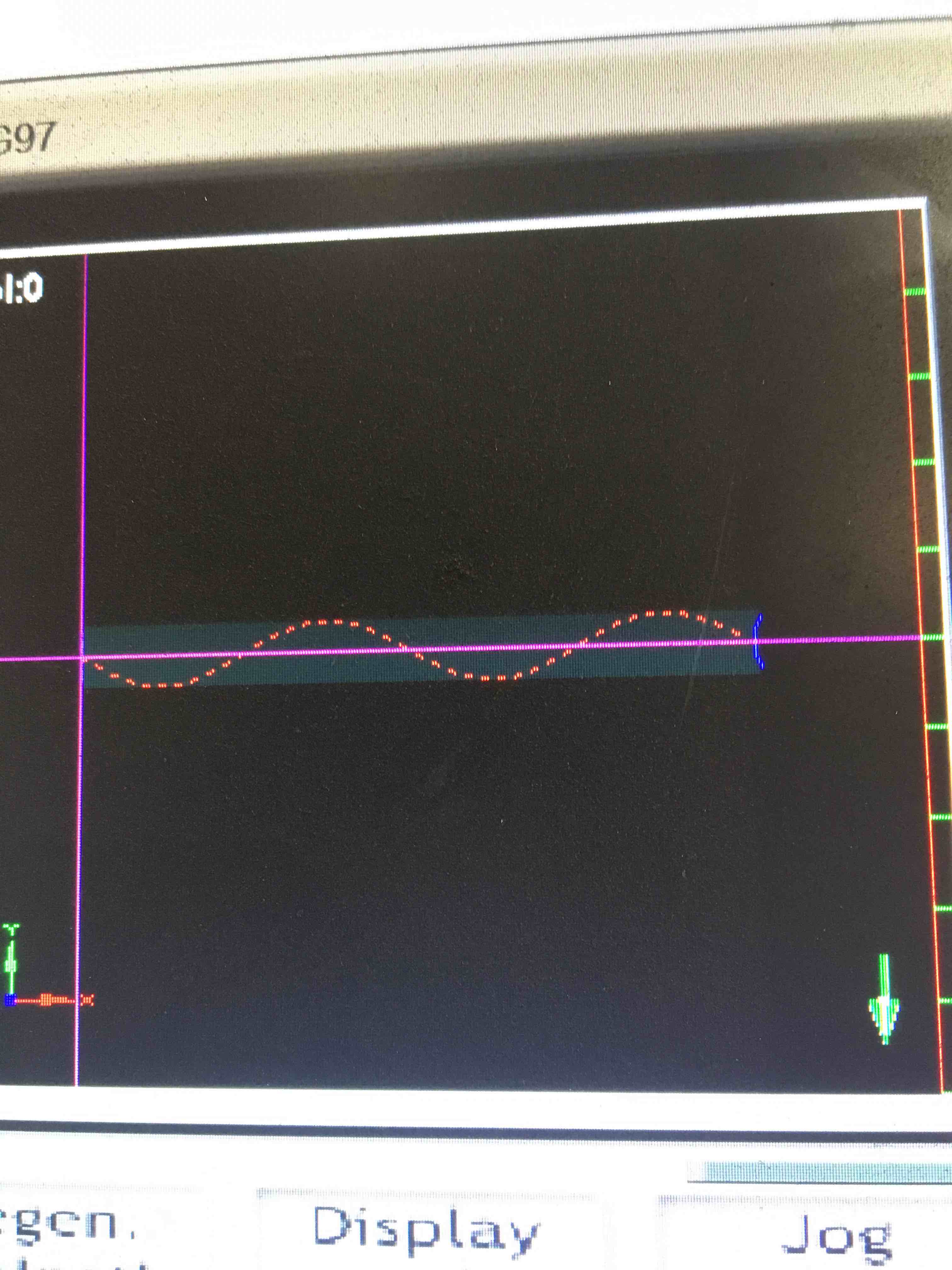

I overlooked a detail in Sheetcam, and now I’m not sure on where to look within the software - if you look at the attachment you will see my machine is zeroed on the left side of the pipe. I want the torch to be zeroed at the right side instead. How would I approach that?
Thanks.
Zero in SheetCam is zero on your machine. You need top move your part so it is to the left of zero. You may also want to move the material origin in SheetCam to the right hand side. You can do this in Options->job options.
