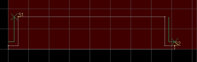

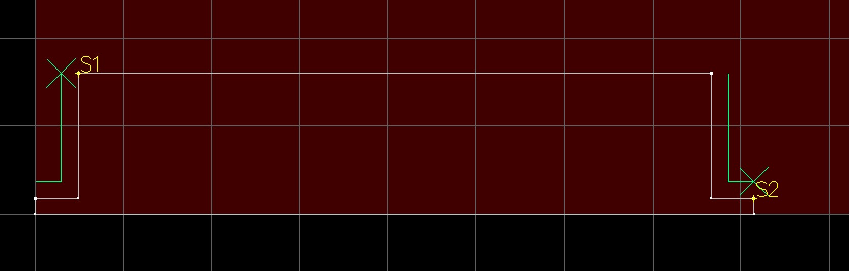

Hello,
I have a simple rectangular part (160 pieces) from which I would like to remove a section from each end via plasma as seen in the attached. I drew it in two layers so I could isolate the two small rectangle drops. I realize that I can adjust my cad drawing to accommodate the kerf width and ignore the offset, but wonder why I am not able to get an outside offset? Looks like an inside offset on screen regardless of selecting inside or outside. Thoughts?
Stevre
PHN-Threshold.job (13.7 KB)
flip the start point to the other end of the open shape and SC will flip the toolpath offset to the other side of the line.
That’s Awesome. Thanks so much.
