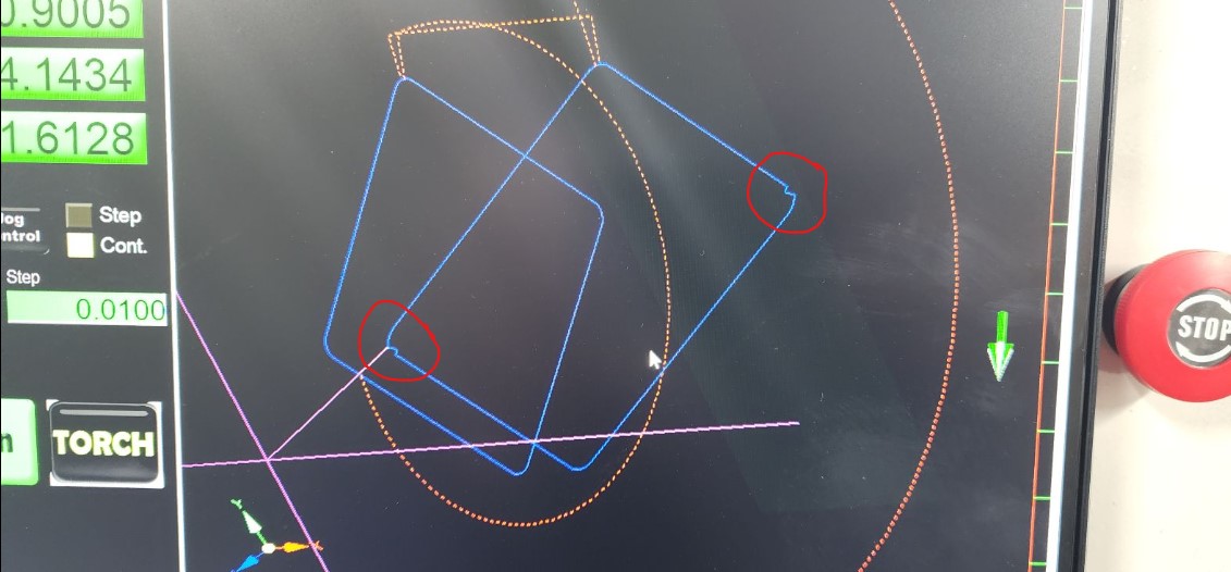

I’ve been using Sheetcam for what seems like forever.
We now have a rotary profile cutter that we cut HSS square tube on.
I’m having an odd issue with how the code handles the corners.

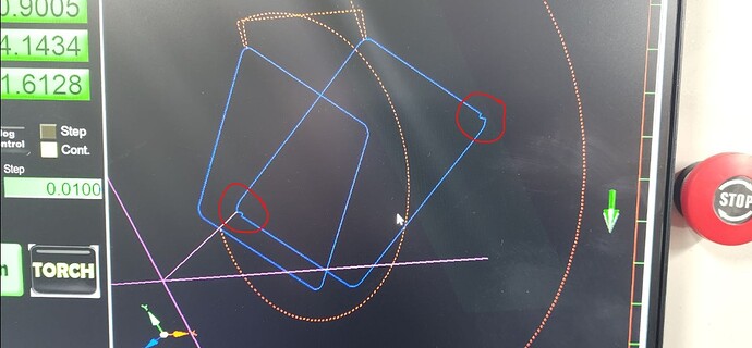

As you can see in the red circled areas, the Z axis dives to cut height while still in the corner.
I’ve found the section of code where this occures:
N57610 X1.7346 Y0.9005 Z4.1234 A-121.6125
N57710 X1.7325 Y0.9515 Z4.1109 A-120.8386 ← I’m still at 120 deg
N57810 Y2.6985 Z3.0900 F9963.9528 A-90.0000 ← This is the issue , it dives from 4.11" to 3.09" while rotating 30 Deg
N57910 Y-2.7250 F59.7073
N58010 Y-2.5141 Z3.3072 F14961.4939 A-85.2744
N58110 Y-2.2817 Z3.4894 F13782.6132 A-80.9223
I can supply the full code if needed. I have 2 of these events on this one part.
Here is the other:
N64510 X5.5389 Y0.5987 Z4.1827 A53.8552
N64610 X5.5433 Y0.8282 Z4.1399 F13234.6662 A57.2957
N64710 Y2.7119 Z3.0900 F10877.1486 A90.0000
N64810 Y-2.7377 F59.717
N64910 Y-2.5021 Z3.3174 F36934.0906 A94.9575
N65010 Y-2.4047 Z3.3966 F13782.6257 A96.8073
This one starts to dive Z with over 32 degs of rotation left.

I’m stumped as to why it’s doing this. I tried changing the starts to make the rotation clockwise , but i’m still getting the issue.

The basic issue is always the same in both posts, when it wraps around one corner, only one corner now, it jumps the A rotation by a large angle. For example, when wrapping around a corner, the segments all span between 3 and 5 degrees, but when we see the error , there is a large jump in degrees, one of the patterns we have been seeing with our cut pattern is either + 43 degree or -43 degree jumps at the corner.
Ex:
N21010 X2.2904 Y-0.1397 Z2.8234 A-48.1818
N21110 X2.2891 Y0.0646 Z2.8265 A-43.5291
N21210 X2.2456 Y1.7734 Z2.0900 F14597.3481 A0.0000
Also to note: The simulation in sheetcam is always fine, but the error is visible in the generated Gcode and in the toolpath generated by mach3
