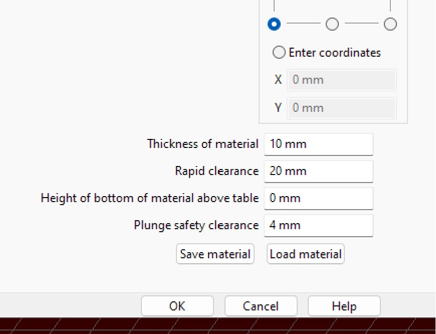

Sounds like the “Plunge safety clearance” may have gotten changed or zero.
These are my typical settings in Options->Job menu…
In the .tap file from yesterday, you had this gcode…
N0350 G00 Z0.9500 – this is motion to Rapid clearance value
N0360 X2.2094 Y0.8913
N0370 Z0.7500 – motion to Plunge safety clearance
N0380 G01 Z0.7100 F20.937 – motion and feedrate to plunge to cut depth
N0390 G03 X2.2094 Y0.8913 I0.0032 J0.0032 F30.937 – shape cutting and feedrate
It should be .200, rapid to .100, then begin cut at Z 0, cut .040 set cuts until depth of .145

Figured it out, I had .750 offset for my cutter length. I thought that was fir overall length of cutter hangout. Now I know better…lol
