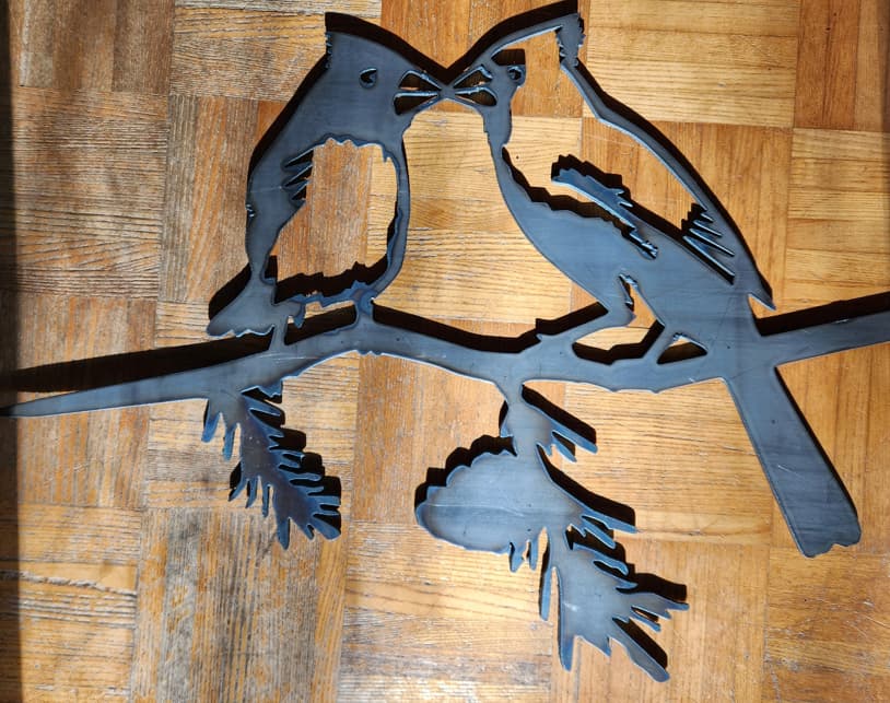

I am new to Sheetcam still, but I have created a Post Processor for the JD’s Garage Plasma Cutter Gen 2 and similar machines that use grblHAL on an ESP32, with the Z-probe. I started with JD’s recommended “GRBL THC with scribe” post processor, and then I made several modifications that made the post-processor work a bit better for me and machines like mine. Also, being a very nerdy software engineer, I also made the g-code a little bit easier for me to follow and modify - and especially to create variants when I need to fix just one part of a cut. The comments in the g-code include a Cut # that matches up to Sheetcam’s numbers (S1, S2, etc.). I’m sure this post-processor is not perfect, I already have seen a few things I’d like to fix, but it works exceptionally well for me - better than the Fusion 360 GRBL post processor (though I don’t attribute that so much to my changes but more to the original that I modified.)

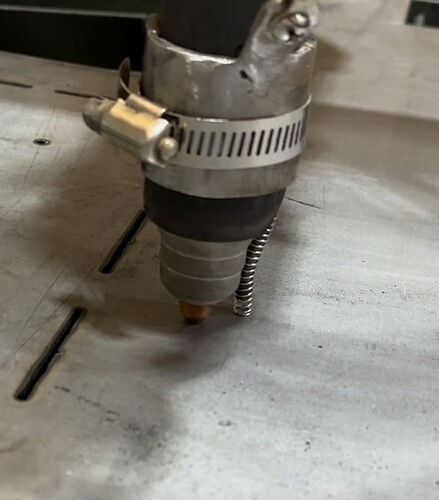

To provide a few more details that may be helpful. My machine is based on the JD’s Garage Generation 2 machine (which for anyone who is not aware comes from a set of plans that may be purchased for $25 US and which appears to be a clone of the entry-level Langmuir Systems Crossfire CNC plasma machine - right down to identical looking 3D printed parts.) I originally built the Gen 1 JD’s garage machine but had a ton of problems with it from problems with the 3D printed parts holding threads, to friction on the suspended arm, to the worst problem of all EMI on the Z-probe. I eventually gave up on their GEN 1 and started modifying my machine. I made it much bigger, added linear rails and a second Y rail and motor, and replaced their Z axis with one from Amazon. I threw out ALL of the 3D printed parts and made everything from metal - except that I did 3D print a breakaway magnetic torch holder. I added a DANI THC11DPL Torch Height Controller while I patiently waited for JD’s Garage to release their THC. (I bought theirs but have never hooked it up, the DANI THC works great, and in my experience, he is much easier to work with and get support from than the JD’s garage guys were before they decided I was too much of pain to deal with because I asked questions.) Because I also had problems with the JD’s garage Z-axis binding up and causing the probe switch to sometimes stick and other problems, when I replaced it with an 100mm Linear Stage Actuator for the Z-axis, I needed to make a new probe, so I designed an ohmic sensor that clamps to the torch and feeds a signal into a CNC4PC PTS-1 Plasma Touch Probe.
It was about the time that I decided to tackle the relentless EMI problems with the Z-probe (that still happened with the PTS-1) that JD’s Garage announced their Gen 2 machine. I bought the plans and converted my electronics over to match (mostly), but using the DANI THC and the PTS-1. I also made several other changes to fix issues with JD’s garage Gen 2 electronics, such as burning the e-fuse that lets you get rid of the otherwise completely unnecessary 2nd relay - which is only there because pin 12 on the ESP32 is a “strapping pin” which can’t be directly connected to the X PUL- on the X motor driver during the first 1ms of ESP32 startup without dropping the voltage to the internal SD storage to an unusable level – unless you burn the e-fuse freeing up the pin, and I modified the grblHAL + Blackbox driver code to send an enable signal on PIN 25 of the ESP32 for the PTS-1 during a probe operation). While redoing the electronics, I also put copper tape around EVERY wire, and I added a bypass capacitor to the Z-probe signal and several ferrite cores to the Z-probe signal inside the electronics box and near the torch. This fixed my EMI problems, and after 2 years of struggling with JD’s garage plans I finally have a working CNC Plasma Cutter!
I switched to Sheetcam because I have been considering selling some of my work (DXF files and/or physical pieces), but Fusion 360’s license is too restrictive and too costly for someone just starting up. A one-time fee for Sheetcam gets me in the clear and as I mentioned previously seems to work better anyway. (I have been doing my designs with Bend-Tech Pro’s Sheet Metal designer - also because it was a one-time license fee.)
Anyway - after my long rambling… The post-processor is attached. The only variables you need to worry about are listed and as follows:
- switchOffset - This defaults to 0.0 because my ohmic sensor doesn’t have an offset, but the stock JD’s Garage z-axis needs an offset to account for the distance you have to lift Z to get the switch to release and have the torch just barely touch the metal. Enter this in mm.
- firstPierceTime - This is left over from the GRBL THC with scriber post-processor, defaults to 0, but might be useful for some machines
- maxZProbeDistance - This is the maximum length of the Z-probe. I set it to the full-travel length in mm of my Z axis. You probably don’t need to change it for a stock JD’s Garage machine, but it is there just in case.
One of my modifications was to make sure there is a Z-probe before every cut. I also added a lot of comments to help make sense of what the g-codes do especially around probes and oddities of the grblHAL (such as the error 33 after a probe on Arcs.)
I hope you find this useful, and I want to make sure that everyone knows that I couldn’t have done it without the excellent work of the author of the GRBL THC with scriber.scpost.
