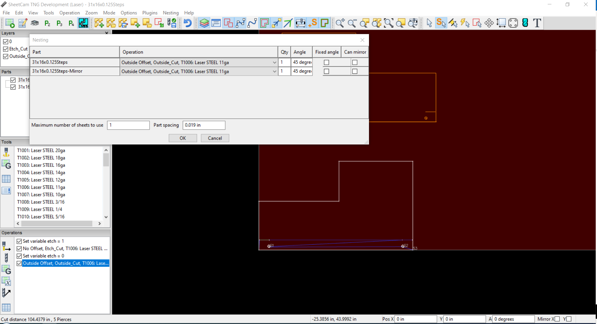

Finally got it to download the 1.1.31 plugin. Guess it was on my end. Now it appears the inch/metric conversions of the part spacing and sheet spacing aren’t happening. I have to put the metric value in the popup box to get nestfab to show the correct inch spacing. Also, there is no box to put in the sheet spacing. It uses the part spacing. Could a box be added to this. I typically use a part spacing of 1.25sheet thickness and a sheet spacing of 0.5sheet thickness.
But this issue still exists. I can fix it in nestfab before i start the nest so not a huge inconvenience, but still a bug.
Hey Les, have you had a chance to look into this yet? The nesting plugin still defaults to metric values and there is no box to put in the sheet spacing separately from the part spacing. Nestfab also only allows 0,90,180, 0r ANY as the rotations allowed instead of being able to type in any number.
I thought I fixed this. I’ll try to sort it out for next release.
