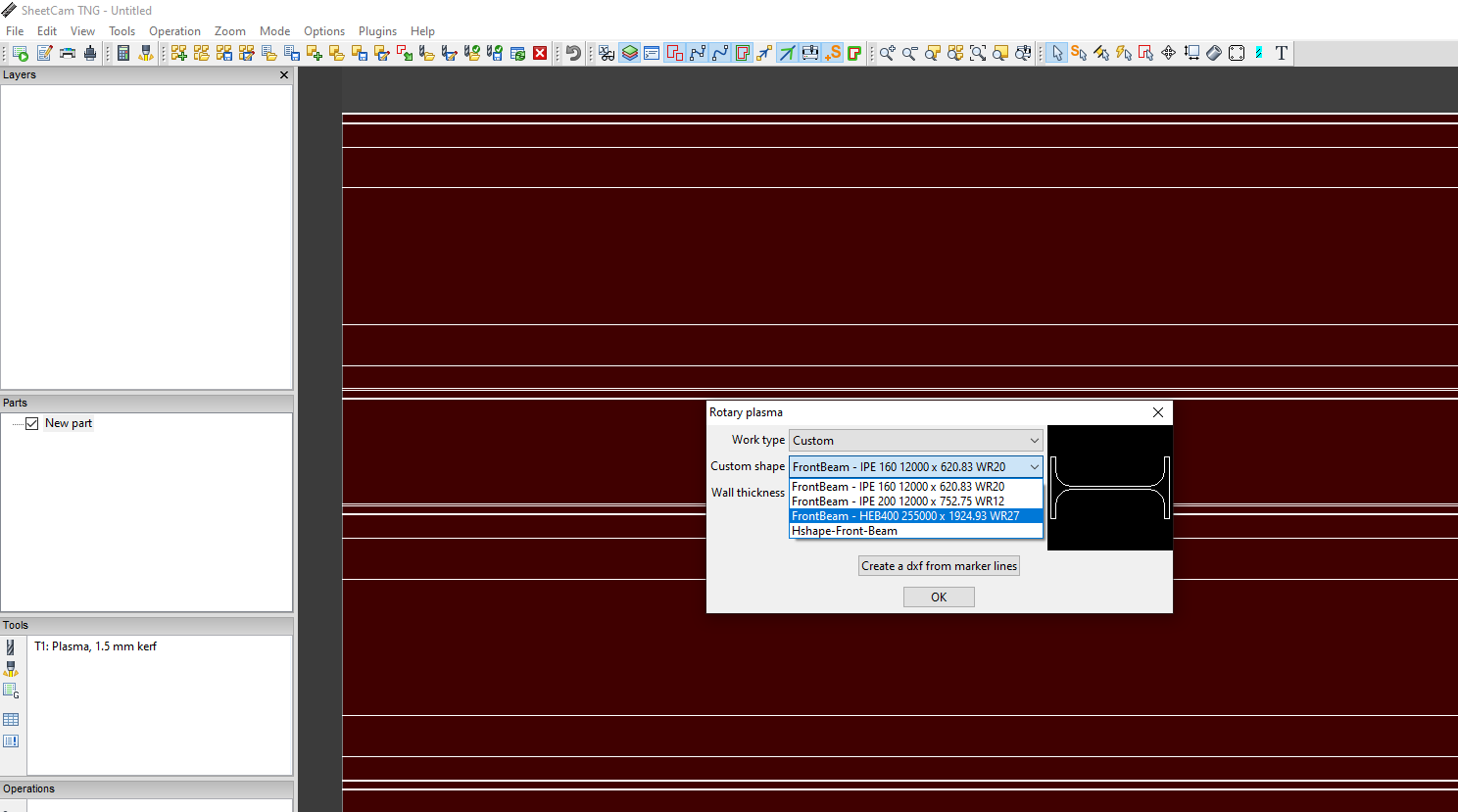

My custom shapes in 'Rotary plasma' settings are deleted (blank) why?
I experienced several times, when I tried to add a new custom shape, my list of custom front-beam.dxf shapes are deleted by unknown reason.
I would like to have list of custom shapes independent from ‘save .job’. Once when I added list of 20 custom shapes I would like to have them for any new .job. Me and my clients are experienced this behaviour.

This happen when user accidentally add already existing contour. Then SheetCam rise a warning, but reloading is not finished properly (I am presume I/O write error occur) and the whole list is gone (not always).

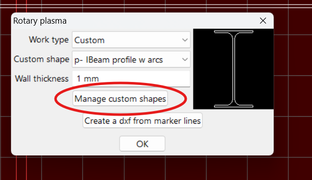

So from this window you select as noted ? …

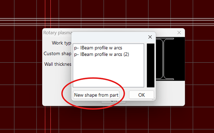

then you select as noted ? …

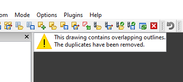

Then you get the warring as you show ?
As you can see, I can’t reproduce that behavior, I actually have a second custom shape created as “name(2)” . No warning.

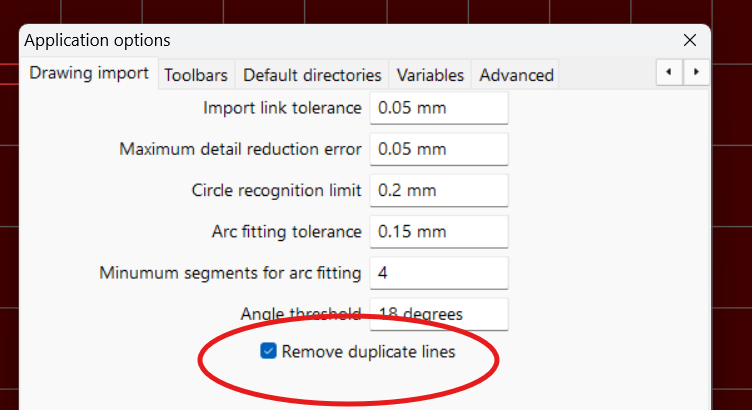

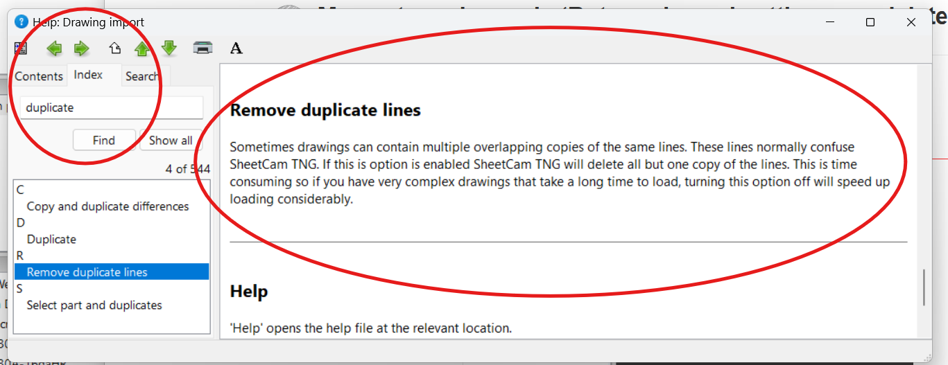

I believe you are getting that warning upon File / ‘Import drawing’ function. Sheetcam is warning you that parallel duplicate/overlapping lines exist in your dxf or svg imported file, and sheetcam has removed duplicate lines per your sheetcam setting to do so. See menu Options / ‘Application options’ / ‘Drawing import’ as noted below.
Follow up to my last post, although I did not get the OP’s warning msg when attempting to add the same dxf as a custom rotary shape, I did just get the same warning upon a restart of sheetcam after having shut it down. When I then look in the rotary custom shapes choices, the previously duplicated shape name(2) is now removed, leaving just the original named custom shape.
