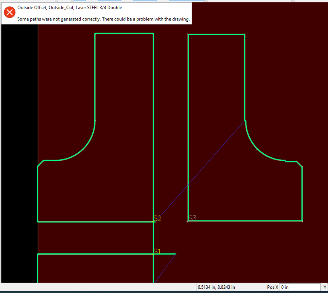

Hey Les, looks like there is still a bug in the move contour to part. Mirroring the profile on the Y seems to work fine, but mirroring on the X did not work so well.

I’m having trouble replicating this. Could you decribe exactly what you are doing to create the fault.
Sure. 1) Import DXF to bottom left. 2) assign cut path. 3) copy contour to new part. 4) mirror across Y and adjust location (top left part). 5) move contour to original part. 6) copy contour from step 4 to new part. 7)mirror across X and adjust (top right part). 8)move contour to original part. Path error comes up.
I did discover if i mirror the original part across X first to get a part in the bottom right and then mirror that part across Y to get the top right part, everything is fine, no error. The error only happens when i mirror Y first then X.
After some testing I worked out the fault is triggered if you move/copy between parts when one part is mirrored in both X and Y and the other is not mirrored in either axis. I now need to figure out why this happens…
Well, that took some finding. It is now fixed for the next release. I also have a new Nestfab plugin for Dev coming up.
