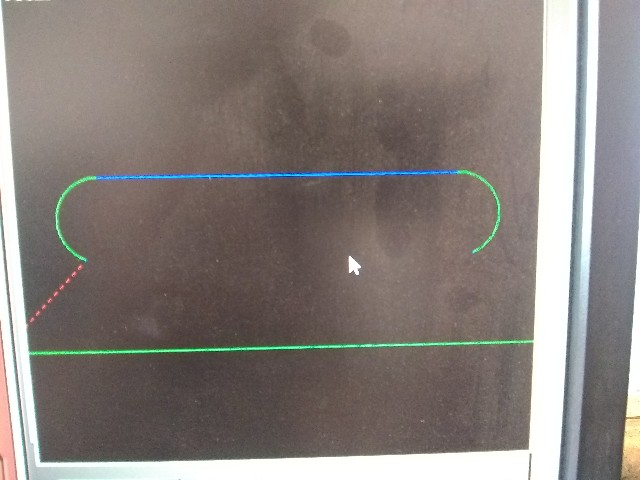

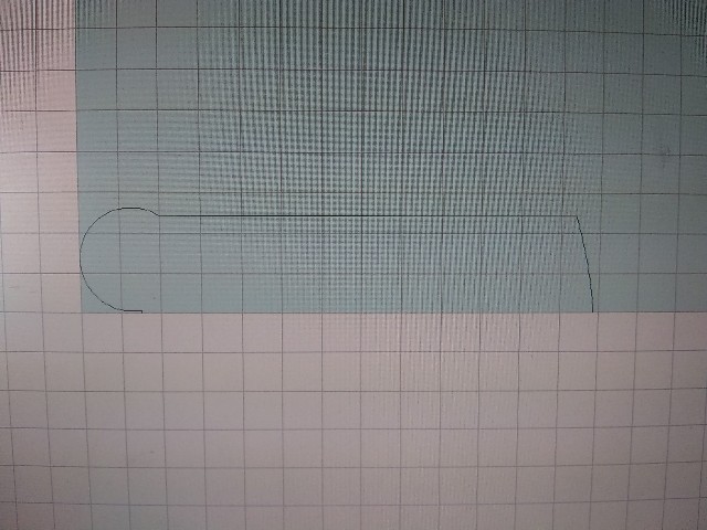

I tried loading a tap file, but it didn’t work as expected. I loaded it as a drawing, since that was the only place I could find the tap extension. I left the default options in the window that popped up, and also tried a few different number formats without success.
Here’s what SheetCam loads and here’s what it looks like in Mach3.
It is an open path that I cut along the edge of a bar, so maybe that is what is messing it up.
That’s an I,J mode problem. It looks like your tap file uses absolute arc centers and SheetCam is set up for incremental arcs. There isn’t currently any way to set the arc center mode in SheetCam
Okay. Not a big deal, just thought it might be handy to be able to get a drawing from the tap file. I would think SheetCam could look for the G90 or G91 in the code and compensate.
It does recognise G90/G91 but they specify if X,Y coordinates are absolute, not I,J coordinates. There aren’t any standard codes to select absolute/incremental I,J
