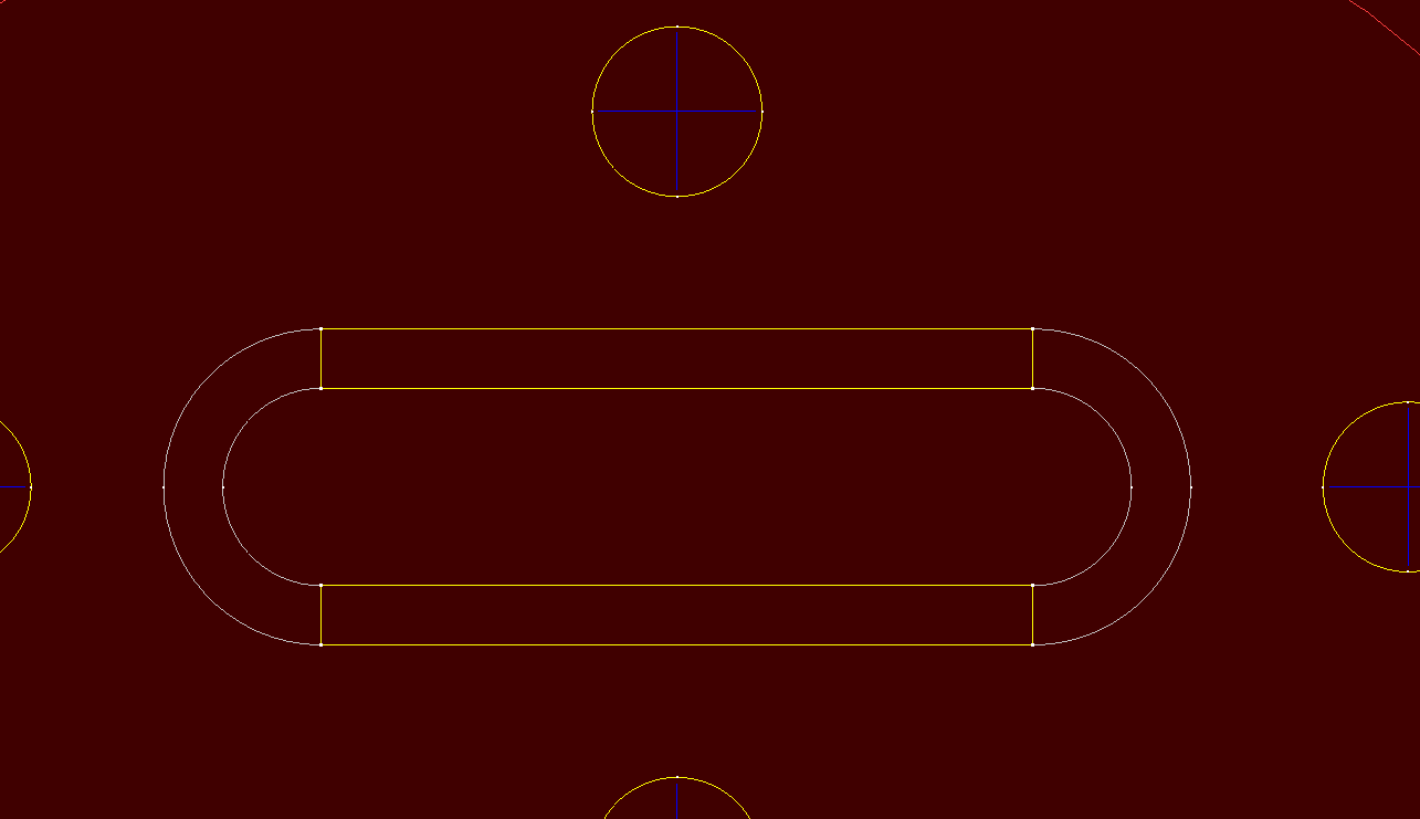

and want the two oval contours to be machined. But the vertical lines are making trouble so they have to be removed or moved to another layer.
At this point it is only possible to move closed contours to a new layer a s far as I know (the yellow coloured).
It would be nice if it would be possible to select also single lines or segments.
Another thing that would be also nice would be to have the possibility to rename and delete layers.
You can select both open and closed contours but currently you can’t delete individual lines. Adding that functionality is a fairly big change so I won’t be able to do it in the near future. I’m still working on getting everything sorted for the new stable release which should have been out in January.
You can rename layers. Turn on the layer tool (View->layer tool). Click on a layer name to select it. To delete a layer go to contour mode and right-click->Select all->from layer then right-click->delete.

Ah the Windows like slow double-click. I tried every other (double-click, F2, context menu…)
But that only deletes the content of a layer but not the layer itself. I can also hide a layer, but for the overview it would sometimes be good to delete it.
