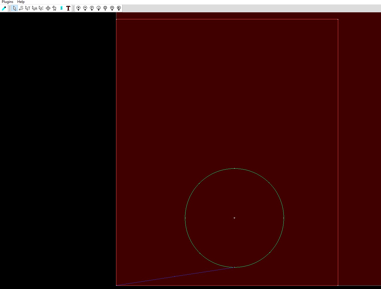

I have plan to make the Cutting machine using the tangential knife .
My machine use Pnewmantic to up and dow the round knife and ‘‘Pen’’ to mark on the canvas.
Im using mach3 to control the machine . The post processor is "Mach 3 Tangential with 3 heads "
When i try to import the dxf file with circle have problem with G02 on Gcode . the Knife not turn .

After G02 don’t have the coordinate '‘x" ,’'Y" .
I’m at a loss now. Any help would be greatly appreciated.
