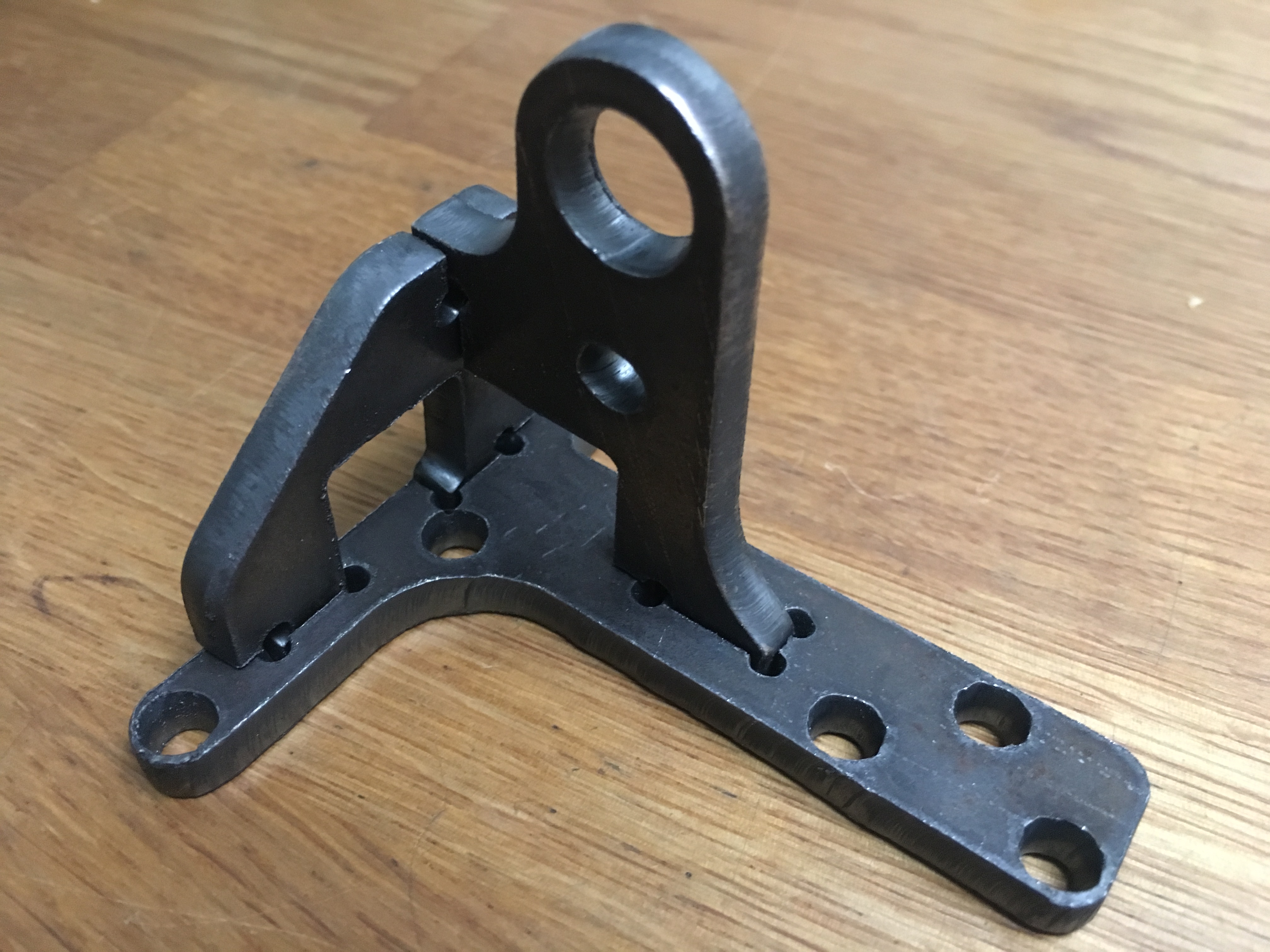

It would be nice to have the option to loop inner corners too. When creating square holes to fit an other cut part you want no radius in the inner corner. I can do a bone like hole in cad but I cant get as good cutting result as when doing a loop. If I draw a loop in CAD then SheetCam make a small extra cut in each corner.

I have used the dogbone technique quite a lot on the milling machine. But when trying it on the plasma cutter it just seems to mess up the angularity of the cut. The outside corner loop feature gave me better angularity near the corner so I thought this could be usable on the inner corners too.
The problem was that if I try to draw a backwards loop in CAD then SheetCam don’t want to follow it unless I do a “No offset” operation. But then I need to do the offset in CAD too and that is a real pain. I did it on the parts in the image above but it took a long time. Not trivial to adjust either loop size or offset.
SheetCam has the ability to do the outside corner loop so I was thinking it might not be very difficult to implement for inner corners.

SheetCam already has automatic dogbones for milling/routing (Cut path tab, overcut corners) but I never implemented it for plasma as I expected problems like mancavedweller described. Internal loops would not be a problem. The current code specifically ignores inside corners so I can make that optional. The only possible issue is that with inside corners enabled, all inside corners will be looped. You won’t be able to individually select which ones to loop.
The loop is reasonable easy to avoid by adding a small fillet on the corners where the loop is unwanted.
Yup, that would work.
Was it too few who wanted this feature to implement it?
Sorry, I forgot to add this one. It will be in the next release.

For some reason no matter what options I fiddle with, I cannot get SheetCam to loop inside corners… any thoughts? (I’m assuming this was an added feature due to the previous replies on this thread)
This is only in the development version. Dev gets the new toys as they are developed. Stable only gets them once they have been thoroughly tested and there is a new major release (V7.x).
Look for the ‘overcut internal corners’ option.
