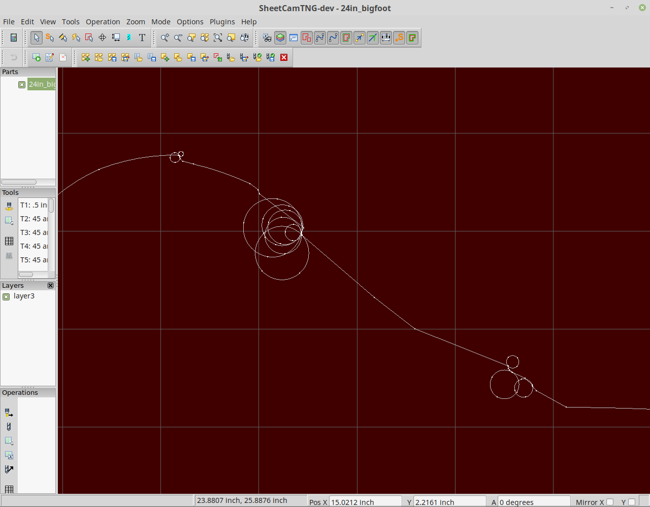

  2. When I import a file with Application options > Drawing import > Arc fitting tolerance set to any thing other than 0 the imported contour shown on the screen contains many small circles that aren’t on the original drawing. Please see attached screen shot. I have checked the source .svg files with other applications and the circles or loops aren’t there with them.
