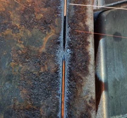

So yesterday I tried the action command and on 2mm steel it worked brilliant (see image).
I set one as a fast rapid move of 500% for 10mm then right after I set a 5mm move with a 70% feed rate. The operation was flow less, you wouldn’t notice the machine actually doing it… next time I ll try on thicker steel, as I think the trick on thick steel is to slow enough after the rapid move to give time for the torch to actually continue the cut.
N.B - on 2 mm thk steel, there was no blow back.
I keep you posted.
Dim

Thanks for reporting back. That does look pretty good. I’ll do some experiments myself. If it works out well I’ll look into adding this as an option for holding tabs. That would save the hassle of having to set up two action points for each tab.

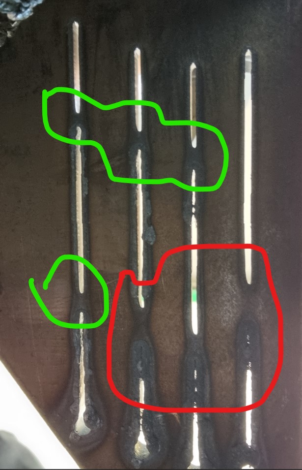

So as promised I did some further testing, this time on some 8mm thk mild steel.
So the first issue I found was that in sheetcam if you try to use the action tab feature on a lines with no kerf offset, the action tab feature does not work well. It does not take into account the distance but simply modifies the feed rate at keeps it modified. After a while I realized that for the action tab to work, one needs to have kerf offsets or cutting on the outside or the inside of a closed shape. I think this is a bug, maybe you can look into it.
Apart from that, I did many testing and realized that actually with only the rapid move, the tab gets created and its kinda irrelevant if you try and slow down the feed rate right after the rapid move! I think its not needed.
If you see the attached image, that is a photo take from the underside of an 8mm thk steel plate, where I was testing. If I had to discuss blow back, the tabs created in the red circle did create some blow back which was noticeable, but as Les mentioned, it did not ever touch the shield cap. The tabs in the yellow circle are ever milder. Usually I cut 8mm thk steel at 1.5m per min at 70amps, and I think running an 8mm rapid of 190% speed is the best solution.

Thanks for your test results.
That definitely does not sound right. I’ll look into it.
If that’s the case it should be pretty easy to add an option to tabs that simply rapids with the torch on.
