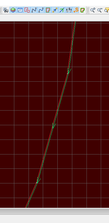

Thank you for trying that but it didnt come out as expected. I tried a donut, the outer size 100mm and the inner 50mm centralized. No sizes were correct and it was off centre too. Ill attach the 2 files from the different softwares to compare. Gcode.zip (744 Bytes)
Perfect, I think thats done the trick. I just have to run some further tests now. Is there anyway of purchasing a month trial? Im hoping its going to superceed the software I have the now moving forward.
Many thanks Les, on the first few runs, the arcs seem to be made up of very large straight lines rather than smooth curves… Is this down to the post processor?
