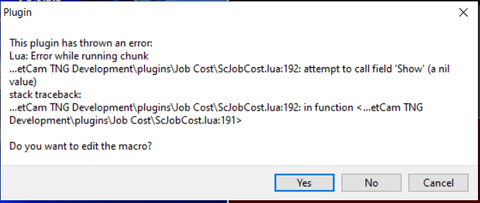

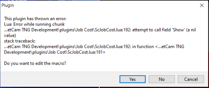

Hi Terry
Tryning to use this plugin but I get an error as below:
Lua: Error while running chunk
…tCam TNG Development\plugins\SCJobCost\ScJobCost.lua:192: attempt to call field ‘Show’ (a nil value)
stack traceback:
…tCam TNG Development\plugins\SCJobCost\ScJobCost.lua:192: in function <…tCam TNG Development\plugins\SCJobCost\ScJobCost.lua:191>
It comes from this piece of code.
panel:Connect(ID_MCedit_BUT, wx.wxEVT_COMMAND_BUTTON_CLICKED,
function(event)
MCE.Show()
mainframe:Iconize(false)
end )

Hey Les, I think I am going to have to call in for backup on figuring this one out. There is a bug in this plugin and it looks like the author no longer has access to sheetcam. I was really hoping to figure it out myself, but that’s not happening.
It looks like the error is happening when the main program calls a sub file in. My guess is it has something to do with the update of the wxWidgets maybe? I’ve tried everything I can think of, but there doesn’t seem to be a lot of stuff out there to read up on this. Or at least not that I am able to find. Everything I look up is rather generic with the classic “Hello World” examples.
Sorry for the delay in replying. I’ve been losing myself in the lathe plugin code. Lathe toolpaths are complicated!
The ‘grid changed’ event changed in wx3.x. This should fix it.
SCJobCost.zip (77.2 KB)

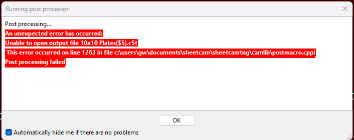

I installed lates SC TNG Developer, I was getting errors as posted above before was able to get the two editor buttons to function now and filled in some fields, but when clicking on pricing button i get this error.
I checked the path, GW user is empty, no folders. That is not my current user, I couldn’t find where to modify the path.
Can anyone help?
I just did some experiments with this plugin and it appears to be quite broken at the moment. I will have a go at fixing it but this may take a while.
