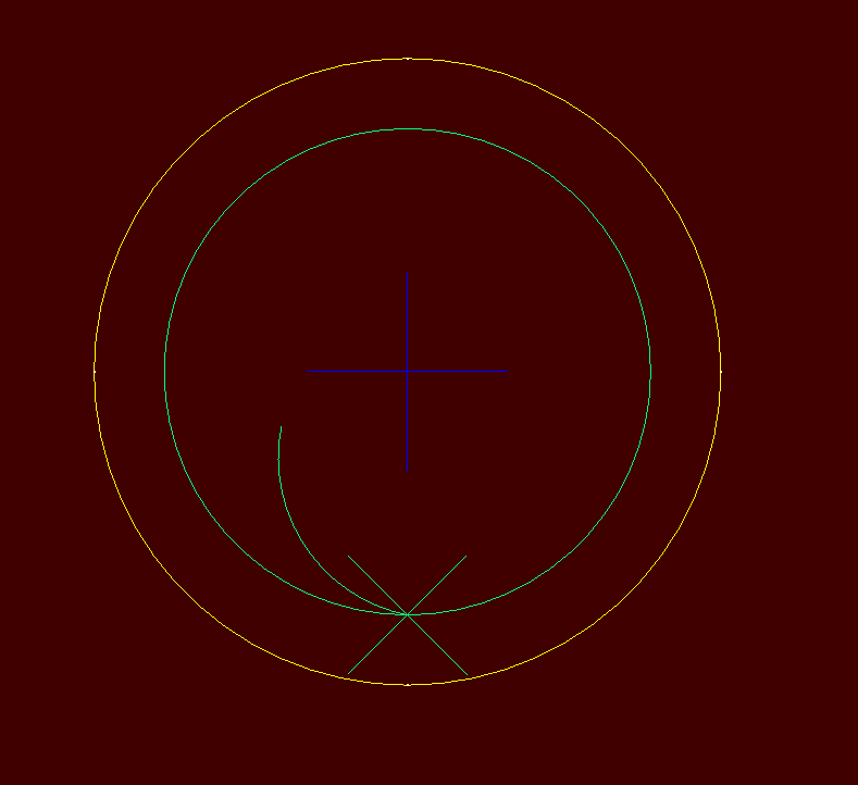

Les is it possible to do a J shaped leadin on holes?
Eg. pierce at the hole centre, then move to the start of the arc leadin shown in the pic. then carry on as normal
This would leave the pile of dross on a pierce as far from the cut as possible but provide a nice leadin more like the Hypertherm true hole technology.
I want to combine it with an overcut which can be done in Plasmac without the postprocessor getting involved.
No I want to cut holes where I can and I want to pierce in the middle but retain an arc leadin which I can’t see is possible. This is to implement some advanced hole cutting that not currently supported out of the box.
I do spot and drill some holes on a separate layer at other times.
