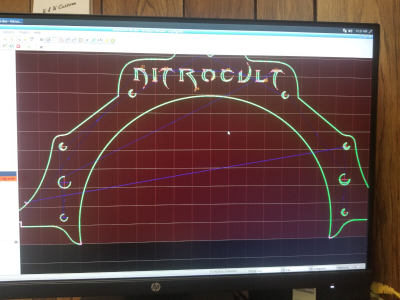

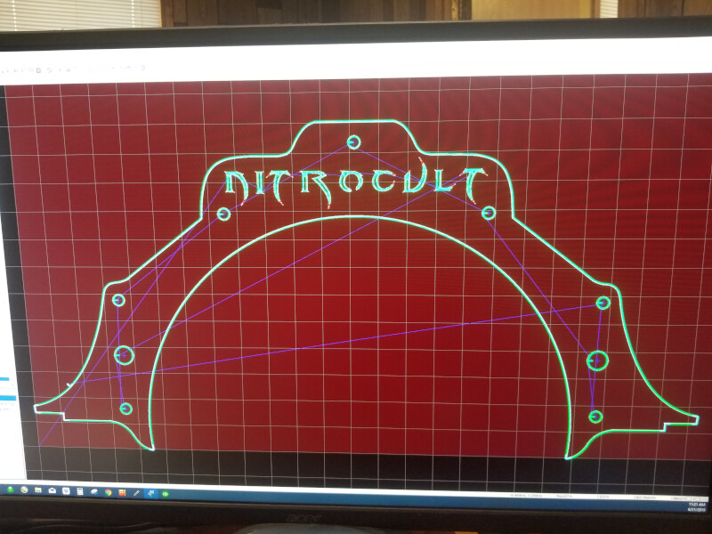

I’ve had this pop up before, but thought it was a drawing issue. It’s popping up again today, and I know it’s not a drawing issue. My file in Sheetcam Windows looks fine:
When I save that as a .job file, transfer to Linux, and open job in Sheetcam Linux, it looks like this:

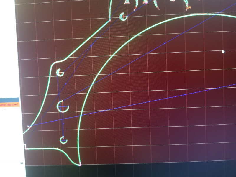

Notice the holes, which are now incomplete. It seems like arcs are where I notice this.
I would understand this more if I was importing a drawing (svg, dxf, etc), but I’m not sure why the change in the geometry as a job file. Any ideas? I have confirmed that my Drawing Import settings are the same in both version (though messing with them doesn’t seem to change anything).

It has all 4 nodes of the holes, and will display an outside offset just fine. No offset or inside offset are boogered up, though.

That’s the confusing part…this job WAS created in Windows Sheetcam, and then the .job file (not svg) was opened in Linux Sheetcam…Linux never saw a raw drawing…just the .job file from the Windows Sheetcam.
That is really odd. The Windows and Linux job files should be interchangeable. Could you send me a copy of that file so I can do some experiments.
Will do. When I run the post on the Windows version, and send that to the Linux box, CommandCNC does fine with it (that’s how I cut it). Opening the .job file in Sheetcam caused the issues.
