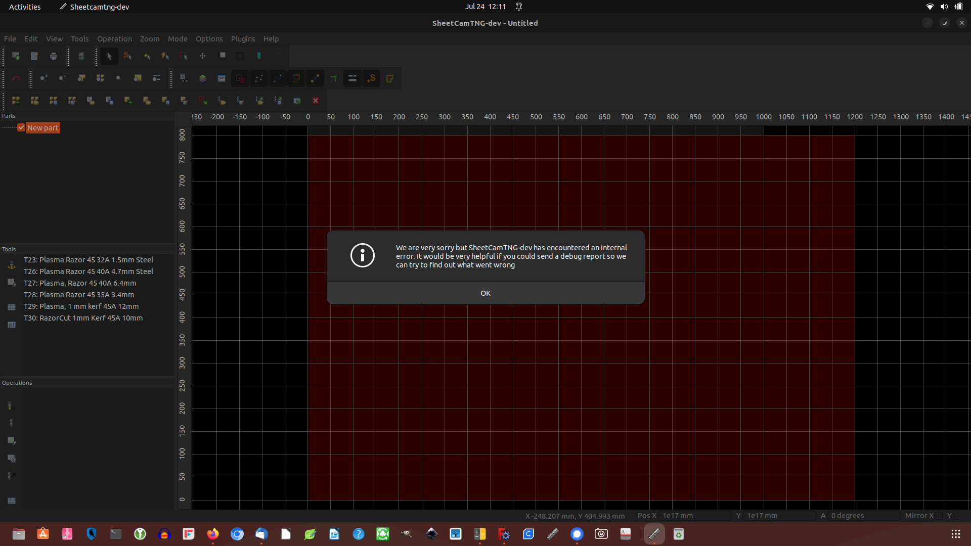

Hi Les;
Step are launch SheetCAM,
Choose import image
I get the Metric/Imperial page
Matrix for orientation
90 vs 96 DPI
Choose the image as per previous attachment
Enter
Then get error page (Screenshot provided)
Then option to create support ZIP.
Let me know if you need anything else.

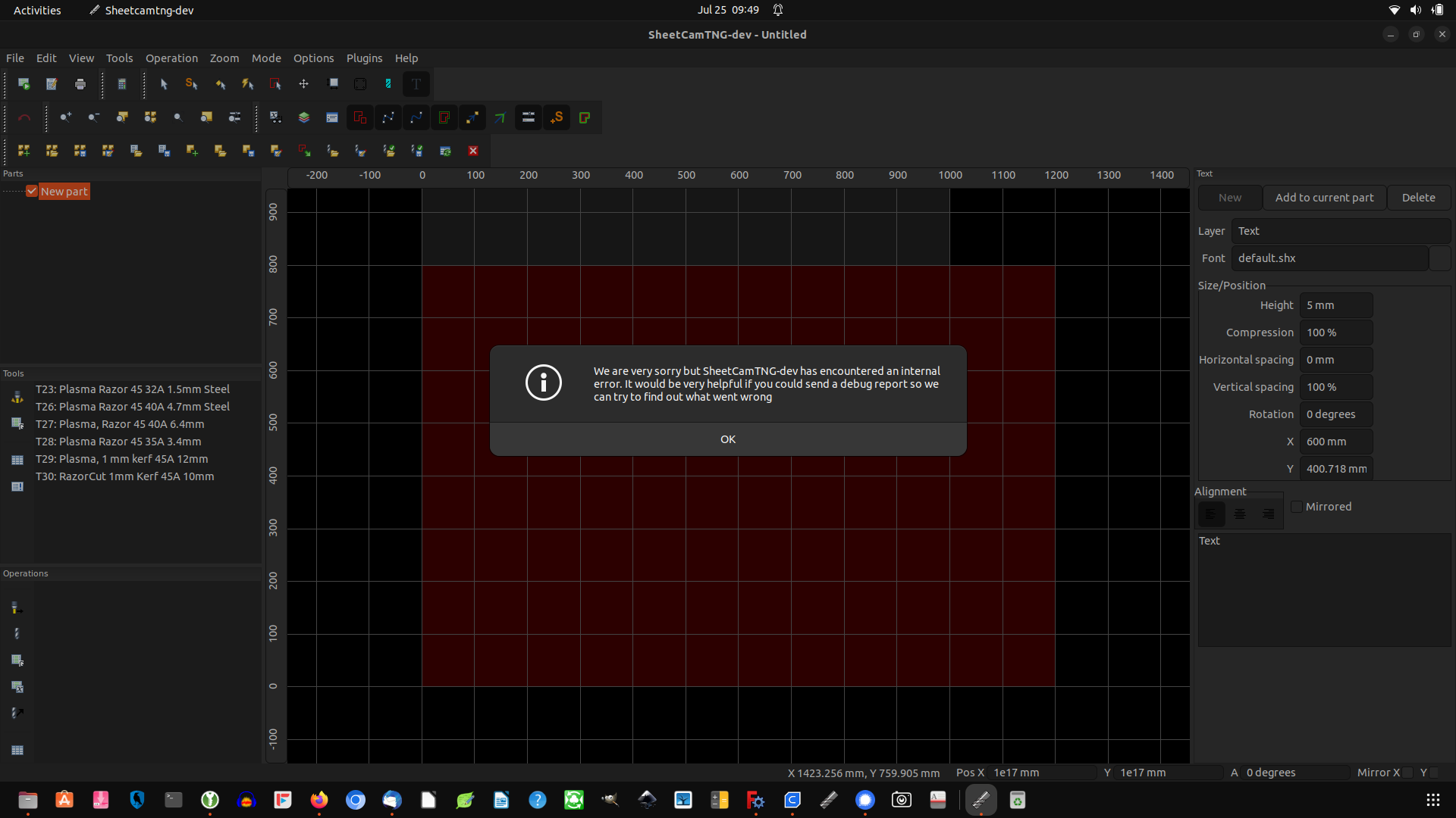

Hmm, the trouble may not be what I thought it was. Go to the text plugin then click on ‘new’ then the three dots next to the font name. Does it crash?
Hi Les;
Text plugin seems greyed out. When I click new, no issue, when I click on options (the three dots) yep you guessed right.
Attached error.
Thanks for the confirmation. Now I just need to work out whyinhell it’s doing that!
Hopefully for the time being you can use dxf. Just don’t enable text.
