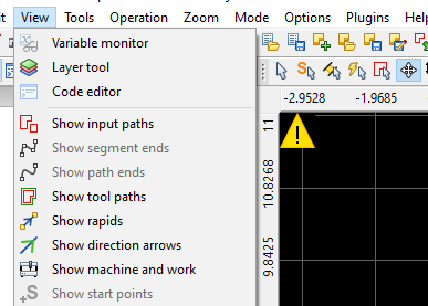

In SheetCam turn off View->show segment ends and turn on View->show path ends. Each break will now have a white dot. Zoom in to see exactly what is wrong.

Les, I know it’s been years since you wrote this but, I’m seeing "Open paths were not offset yet, when I go to turn off “show segment ends”, I find that it is not on and “show path ends” is greyed/not available. What am I missing, O wizard O wise one?
You’re in nesting view. The crossed arrows. Switch back to selection view, single arrow. Some things don’t work in nesting view.
Awesome! thanks for that. (still don’t see the open path but at least I can toggle the view!
If you turn on path ends you should see a place that has 2 white dots close together. That is the ends of the open path. If you fix the issue in your CAD program by closing the path, the error should go away.
It could also be a short line segment hiding behind a closed path border. Look for 2 white dots on a closed path. You may have to zoom way in to see the problem.
If you upload your drawing or job file, someone can try to help you find it.
Appreciate the help! Oddly enough, I was cleaning up the svg and, when I brought it back into Sheetcam, the warning disappeared. Musta been something too small to see but I accidentally fixed it. :smiley: Now I know how to look for it!
