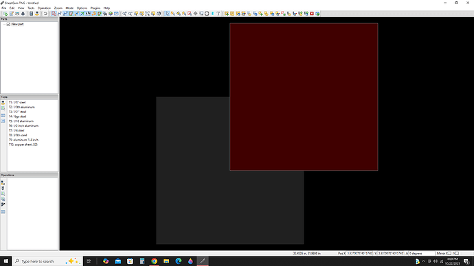

where did the grid come from on the computer screen?
The screen that shows the table shows 2 tables over lapping just a little.
I can’t figure out what the heck I did!
Is there someone I can call to get help?

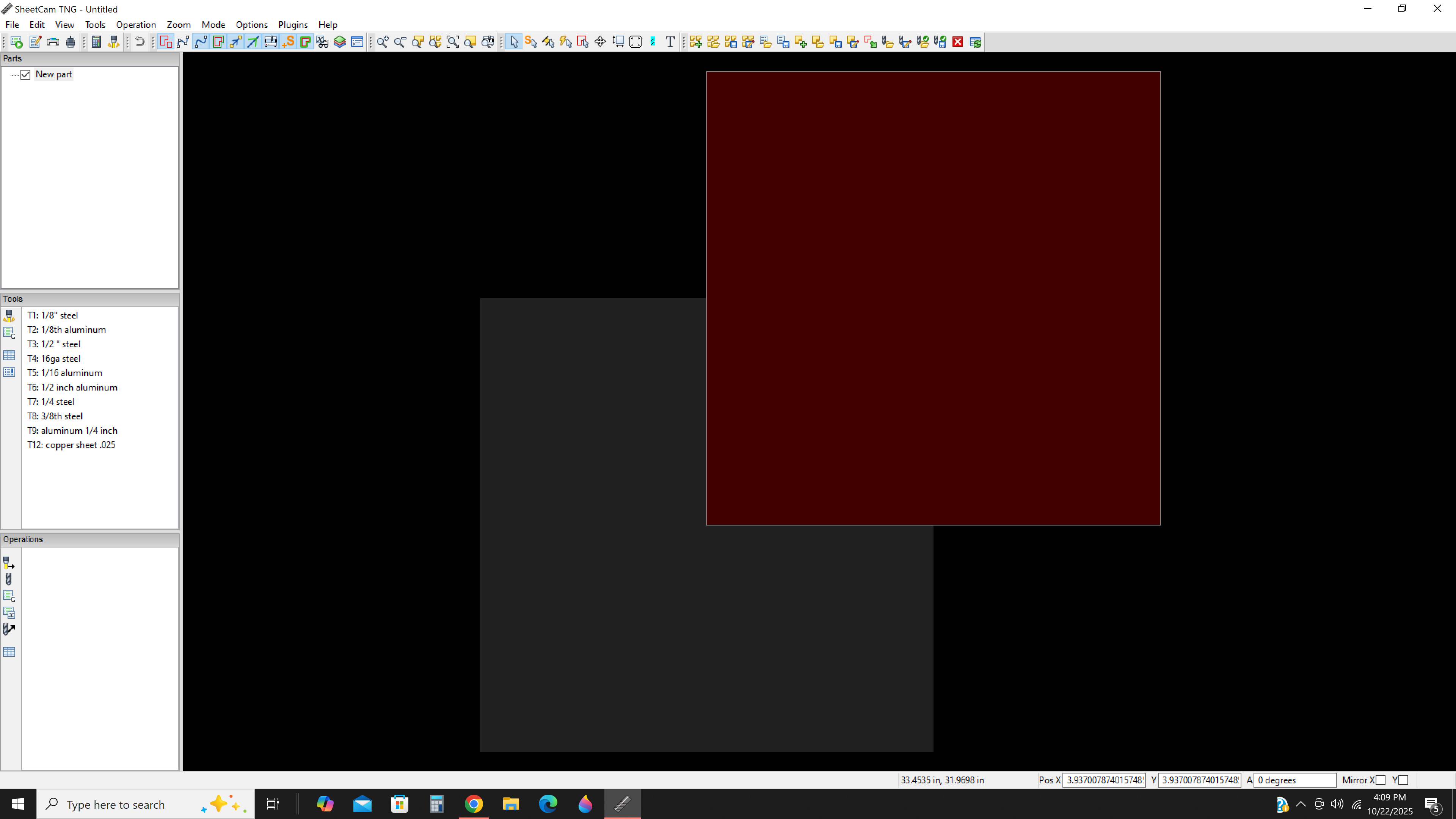

when in menu Mode / ‘View toolpaths’, right click on the drawing and select ‘Show grid’.

Guessing it’s the material and table rectangles are not aligned at 0,0.

So here is the other problem I can’t figure out.
Where is the magic button to get rid of the dark gray box?
Or just combine the 2?
The computer keeps telling me I am outside the table size.
Thank you for putting up with this old guy.
menu Options / Machine / ‘Work envelope’ and ‘Table display’. set them both to dimensions of x0y0, and make sure the Origin location is as you want it, usually bottom left.
really, you need to read this stuff and watch the videos.
