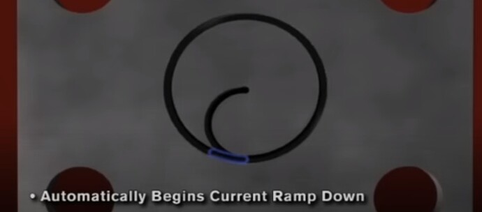

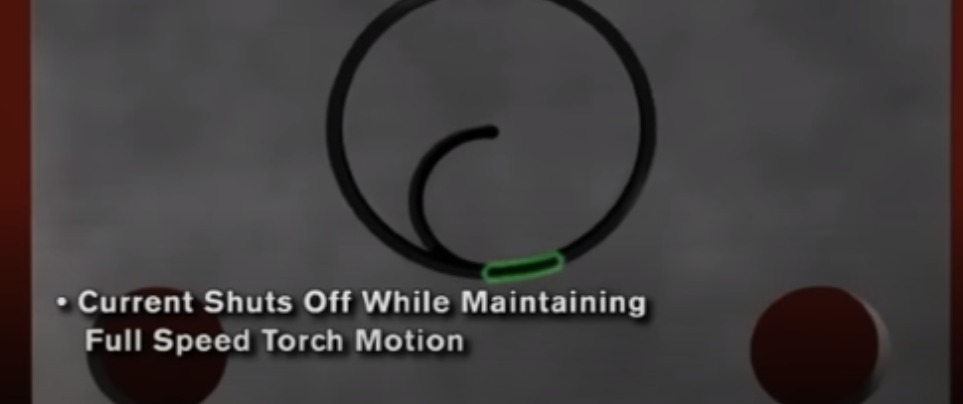

I have a plasma cnc and make the gcode with sheetcam.
but i can find the right setting.
I cut a hole:
  1. Lead in
  2. Cutting speed 60%
  3. ?? 3mm for end shout be begins current Ramp down (See Picture 1)
  4. ?? 3mm current shuts off while maintaining full speed 100% torch motion (see picture 2).
How i can set this in Sheetcam

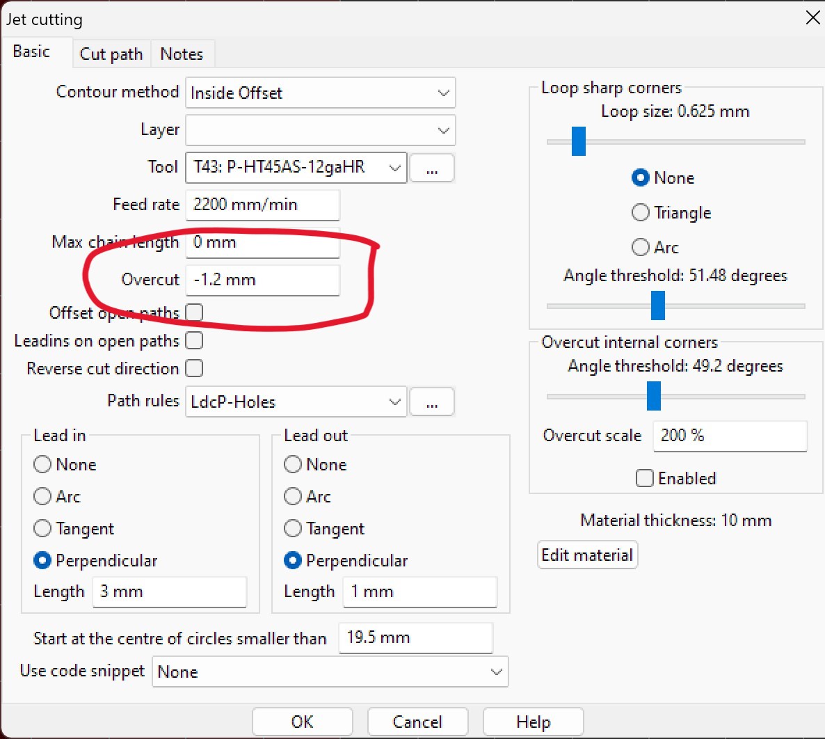

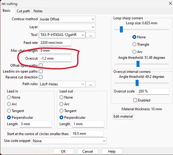

attaching a job example with Path Rules and Overcut implemented.
Several fields to setup to get this behavior.
  1. use a 3mm OverCut in the Jet Operation.
  2. No Leadout.
  3. make a Path Rule Before End 6mm to run code snippet to ramp down amps. (I assume you know the gcodes to use and that your controller consumes it while maintaining continuous motion.)
  4. make a Path Rule Before End 3mm to run code snippet to shut down amps. (assuming your controller consumes the gcode while maintaining continuous motion)
    PathRules Example.job (5.86 KB)
How i can find it in sheetcam?

re. gcode to ramp down cutting amps while maintaining continuous XY motion- not all CNC controllers have this capability. You’ll have to check the manual for your CNC table controller. And in addition to that capability, the plasma source that you are using needs the capability; likewise check the manual if necessary.
Perhaps some folks following this forum will know also. What brand and model is your CNC table, controller, and plasma source ?

re. Overcut setting:
this is right. it´s the same.
