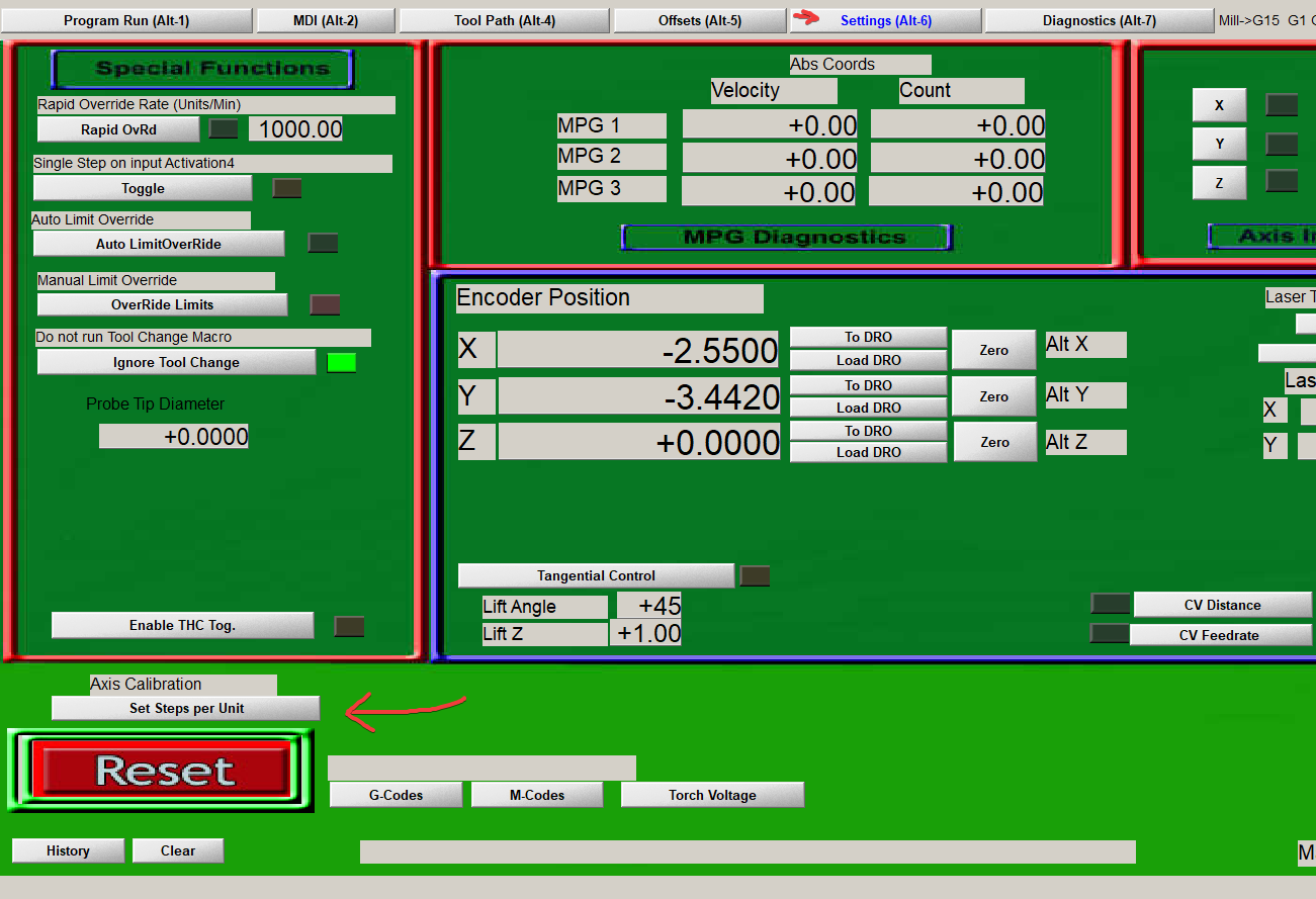

You need to figure out the correct steps per unit on your rotary axis so 360mm = one full rotation.
If it’s hard to calculate, you can try using this “Set steps per unit” functionality on top of the reset button in Mach3 settings tab:
With that you can “calibrate” your steps per unit.
It works like this:
First you input the amount of movement you want on your rotary axis, for example 360mm.
Then Mach3 moves it 360mm (or what it thinks 360mm is)
You need to measure how much the rotary axis actually moved and input that measurement on the next dialog, then Mach3 will calculate the correct steps per unit.
You may need to do it a couple of times, first to just get “close enough” and then do more accurate measurement.

Based on your information, I configured the rotary axis correctly. Thanks.
