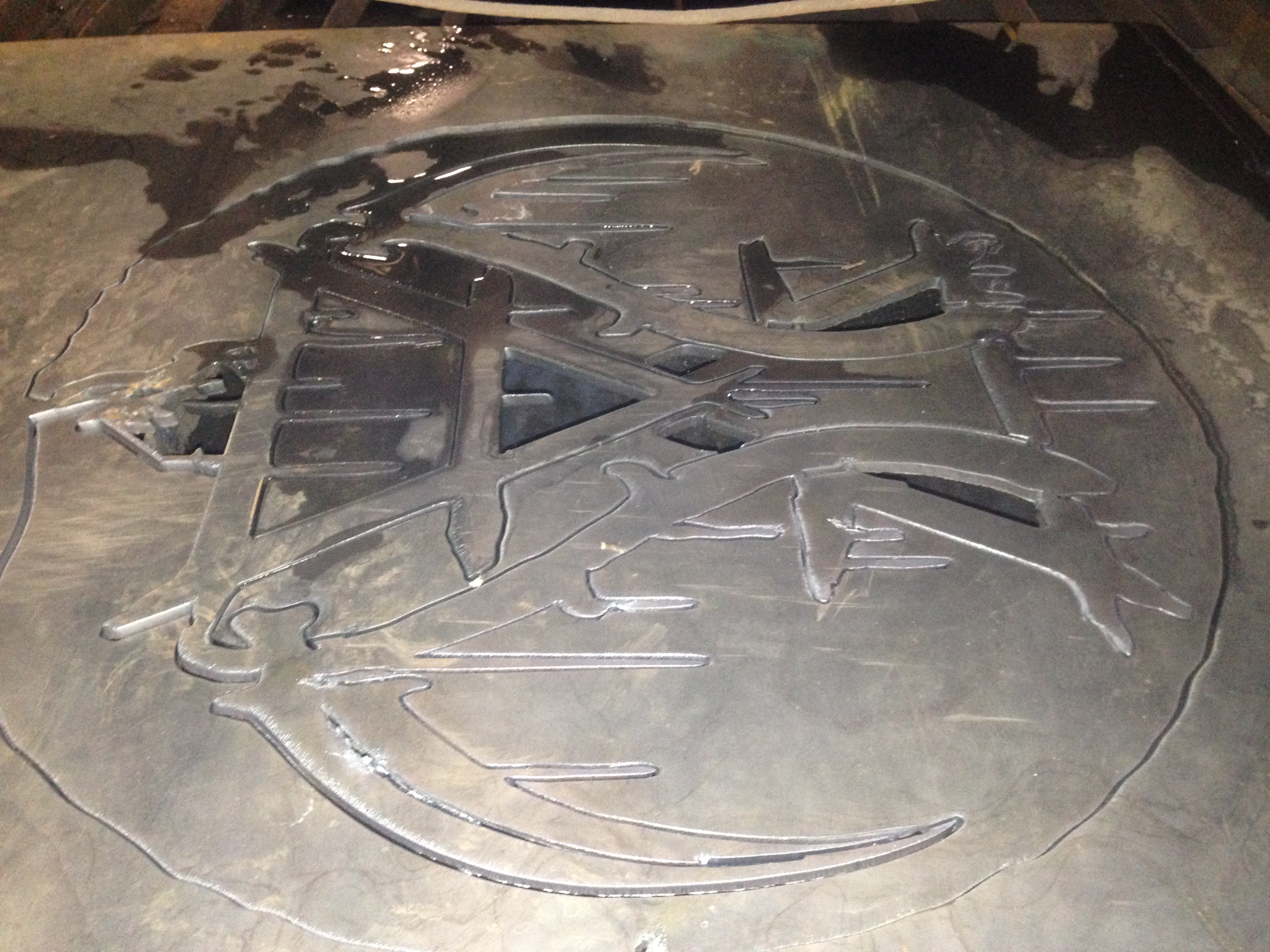

I have a mach3 with proma thc compact and i put the probe on to detect the plate proma is doing THC and is not that bad but my plate is all bend from cutting so when i star z will be very difrent in some parts of the plate i find in proma website the code but not sure how to put it on the post of sheet cam

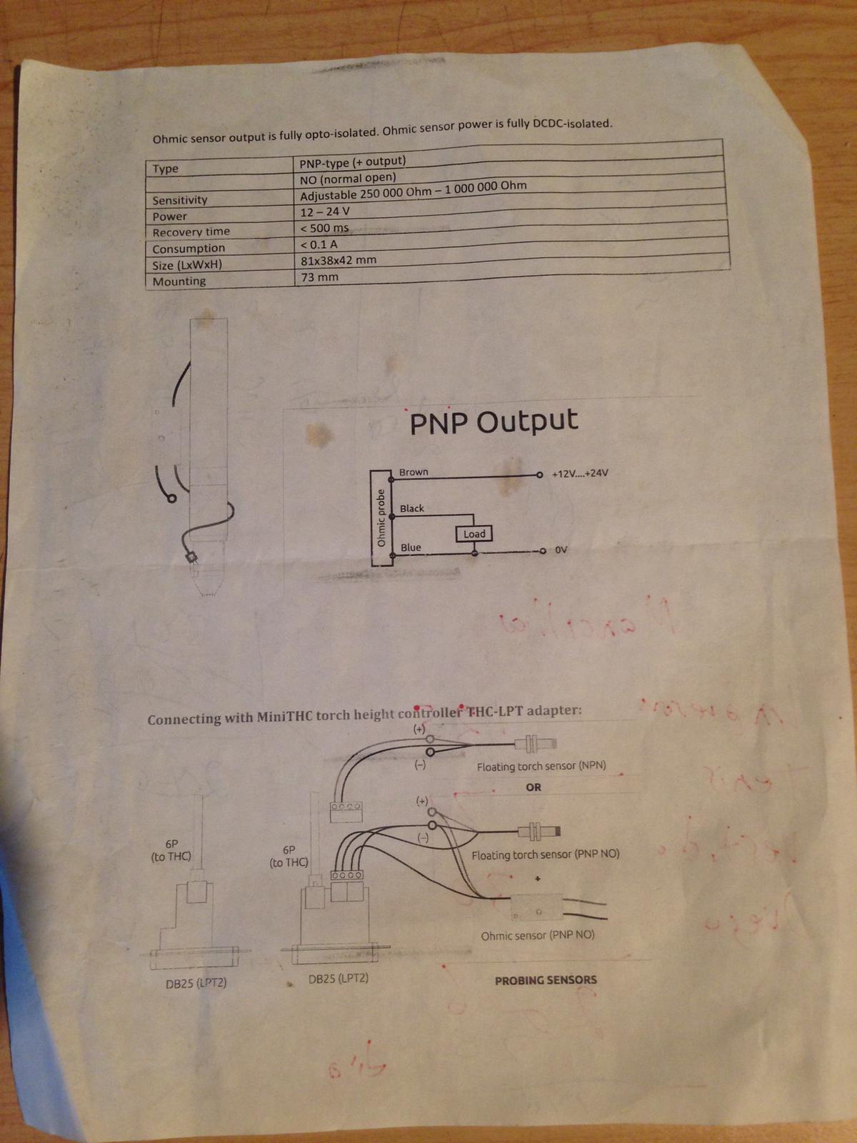

I buy a ohomic from Rusia Federation , I dont longer have Ebay acount so I lost the contact , Im. ataching a picture of the instrucction
i have no isea where to conect on the side that are to wires one is red the other one is blue
the other size go to 3 cables , where i have the tource there is a sensor that have those 3 cables so I will guess they go there
i use gecko 540 Board and i only have one input left if i dont use any limit switch im using the other 3 inputs for proma
do I need to explain more ?
thanks for your help
It looks like the brown goes to a 12-24v DC power supply positive. The blue goes to the negative of the power supply. The black wire goes to the input. It should send the positive voltage to the input when the sensor is touching metal.
I’m not familiar with using a proximity sensor like this for height sensing. Usually most height sensors are ohmic and work like an ohm meter. Hopefully someone using this type of setup will reply and confirm that this will work.

i just email the guy of the Russian Federation find his post on ebay

PD i need to finish the job on my table but the plate bend and need to be able to make my machine find the plate , the job is been on may table for 3 weeks know but customer ( friend need it yesterday )

your information on the THC is available here:
https://minithc.com/
The contact is Denis Yusupov (email address on the contact page)
https://minithc.com/pub/MiniTHC2_EN.pdf
https://minithc.com/pub/Ohmic_Sensor_EN.docx
