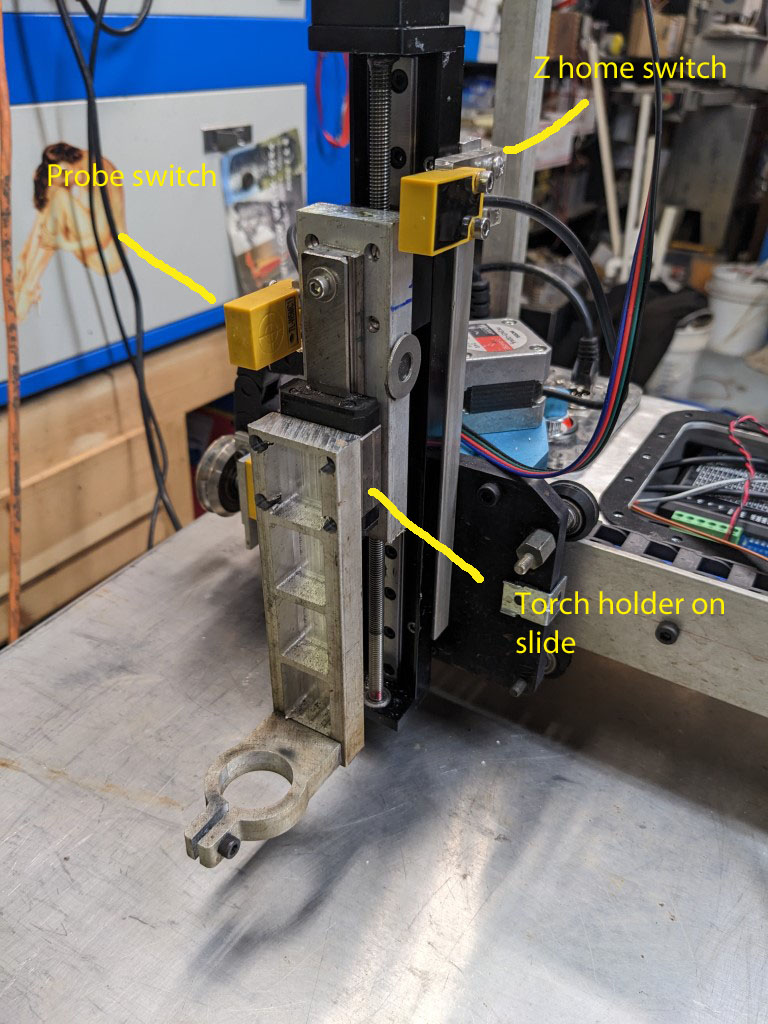

I’ve built a CNC plasma cutter with a floating head. (torch is free to move up and down on a linear slide) I have a proximity switch that triggers about an inch after the torch head meets the material as it moves up the linear slide.
I want the Z to move down till it senses the material and then tell Mach to pull up (about an inch in my case) to set the torch to the proper piercing height.* I have a floating head that moves up and down and a proximity sensor that is triggered after about an inch after the torch hits the material pushing it up triggering the probe signal.*

What will I need to do to instruct the machine to probe the material then pull up a certain distance (again, about an inch) so the torch is in position to fire and pierce?
I have SheetCam and am learning it. Any suggestion as to what post processor to use with Mach 3 and the CNC4PC THC-1?

Your settings look reasonable apart from refHome. It should be:
refHome=false
Note that false is all lower case.
Not sure what this means by ref distance???
If you have multiple pierces close together the post won’t bother to re-reference on each pierce. refDistance controls how far the torch has to move beforfe it references again. Lasve this as is for now.
At what coordinates does the torch crash into the work? If it is at X0 Y0 I’d say your touch-off may not be working correctly.
I’m seeing an M62P4 in your code. That looks like the result of a cutting rule. Is Mach3 configured to understand M62?

the machine will cut the entire 6 inch line put with no Z movement and simply pushes the floating head upward as the torch travels up the incline.
“I’m seeing an M62P4 in your code. That looks like the result of a cutting rule. Is Mach3 configured to understand M62?”
I don’t know. Is this a macro thing? How would I check to see if Mach 3 is configured to understand M62?
Thanks for your help here!
I just got word back from the guy at CNC4PC and he says that Mach3 does not support M26/M63.
He suggested using post Mach3 plasma no Z.scpost while he’s working on a better version for the THC.
