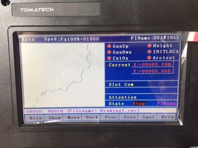

looking for a post for a HC4500 plasma controller , found one in sheet cam, but my unit just looks like a bunch of arcs?
the odd file i had produced in deskcnc works,
it uses m7 and m8 for plasma torch, i used m3 and m5 in the past
I had been using a cnc4640 but wanted to add thc so purchased this hc4500 plasma unit, looks the same but software is completely different!
and my files don’t work
[img]IMG_6588.JPG/img][img]IMG_6584.JPG[img]IMG_6588.JPG/img]/img]
this is what I get, any help available, someone must of had this before?
Are you using the ‘Adtech HC4500 abs arcs’ post processor? If so, try the ‘Adtech HC6500’ post.
Yes try that one similar results just a string of arcs?
I can’t see any adjustment in the controller , funny but my old deskcnc files sort of work ?
