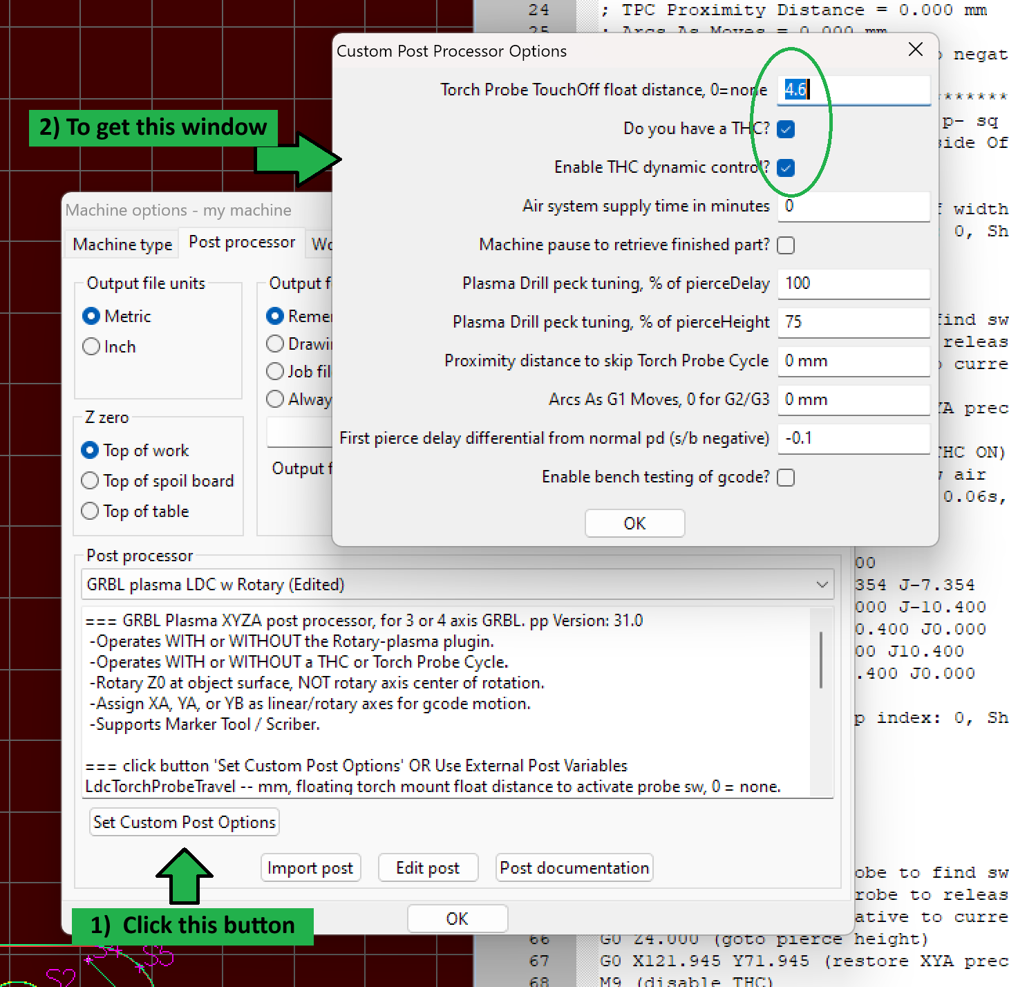

GRBL Plasma w THC, Torch Touchoff, and Rotary
reminder that the Torch Probe Touchoff cycle motion changed back in v30.4, which causes the torch float distance value to change in the pp custom options setup, it will be a smaller value than previous versions.
See this topic and the linked topic it has for explanation.
see also last weeks v31.0 topic as to how to measure torch float distance now.
