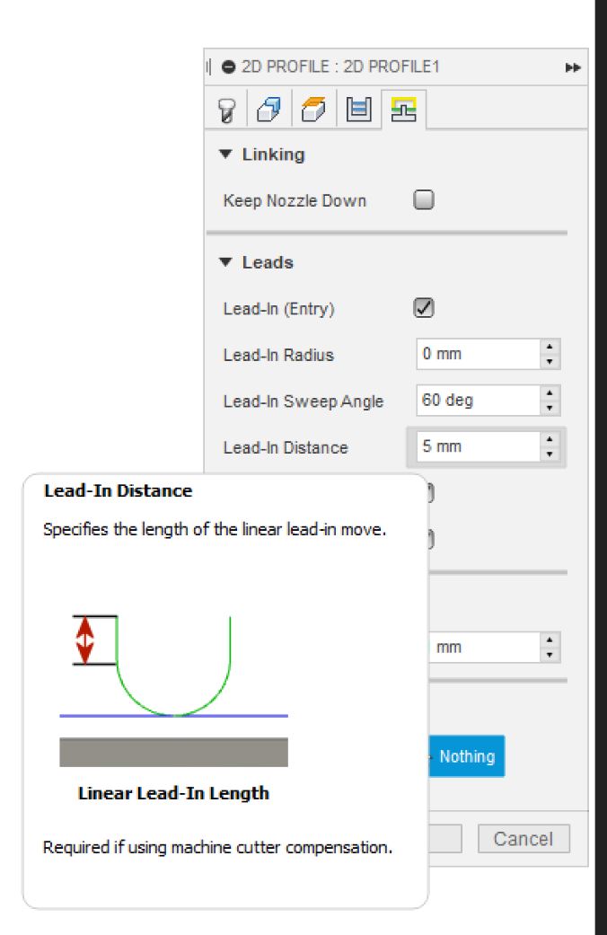

I need this because my controller only accepts “linear move” as the first move in a contour when offset compensation is active.
so if i am using “lead-in/Arc” i get an error when G41/42 is active.
i think “arc lead-in” is preferable when cutting holes in thin material at high speed, you get a more consistent velocity, less jerk in the gantry.
I have done some testing with moving the offset compensation before the rapid move, and its working fine.
another solution would be to add line segment to the arc lead-in, like in fusion 360 (see attach picture)
