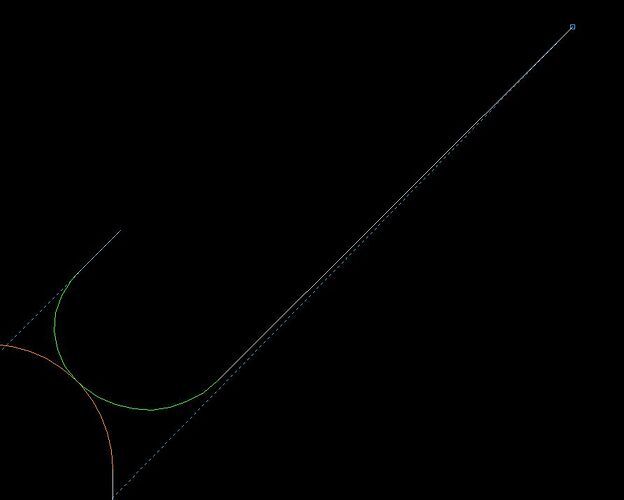

In SheetCam, when I try to use arc or tangent leads to go into a corner optimally (no sharp changes, no thin webs) I get no joy - it seems like the software only applies leads along contours, and at a corner it simply wraps around to the next line.
arc lead fail
arc lead fail 2
Tangent lead fail
Tangent lead fail 2

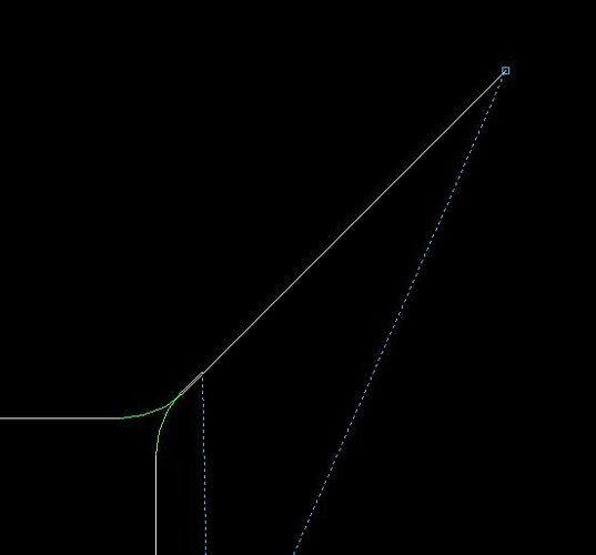

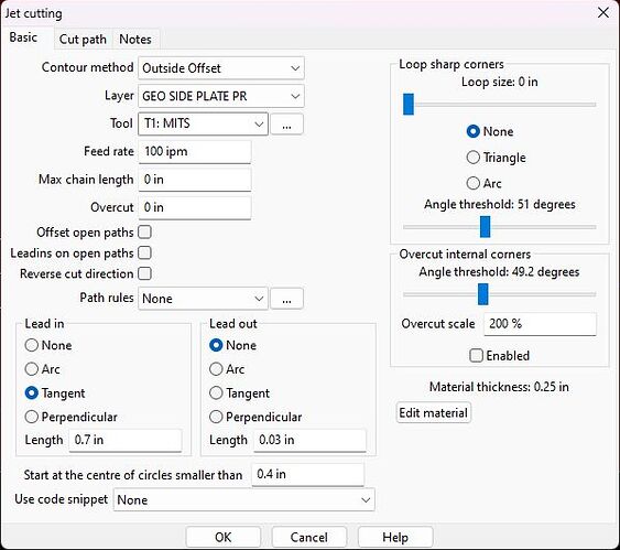

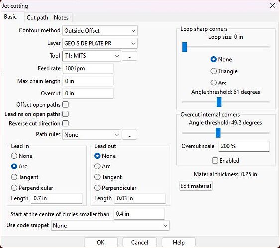

So, running development version 7.1.36, I get almost the same behavior.
On an open pathway, tangent leads will attach to the end and come in parallel.
But once we move to closed paths, it’s the same behavior as before. Arc or tangent lead.
It’s still wrapping around to the other side once I get close to a corner.

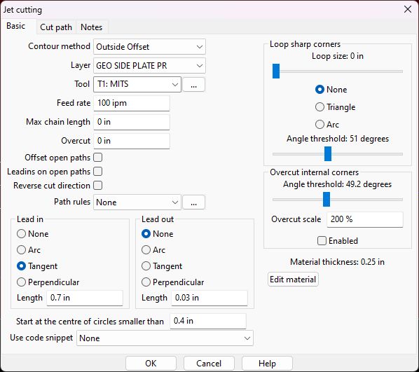

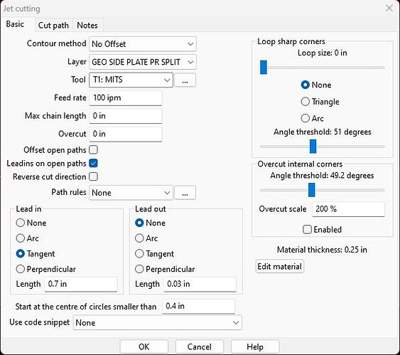

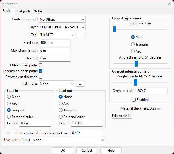

I double checked this morning, and I can’t see any settings that would be causing it, but I can post screenshots if y’all want to review them if that might help.

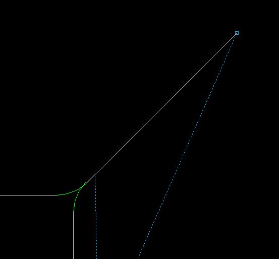

Is this the sort of thing you are looking for?
Yes! That’s exactly the kind of thing I’m after.
Running parts this morning, I tried something on a lark and found my problem.
I have been running the system with a kerf width of “0.000” and doing offsets through cutter comp. Changing kerf width to “0.001” immediately resolved the behavior - the leads all work exactly as one would expect. Turns out kerf width <0.001 causes some wonkiness in lead creation at corners.
I’ll play with this more and update as needed. We may just switch to a 0.001 tool in the meantime.
A kerf width of <0.001 is rounded down to 0. That would explain it.
