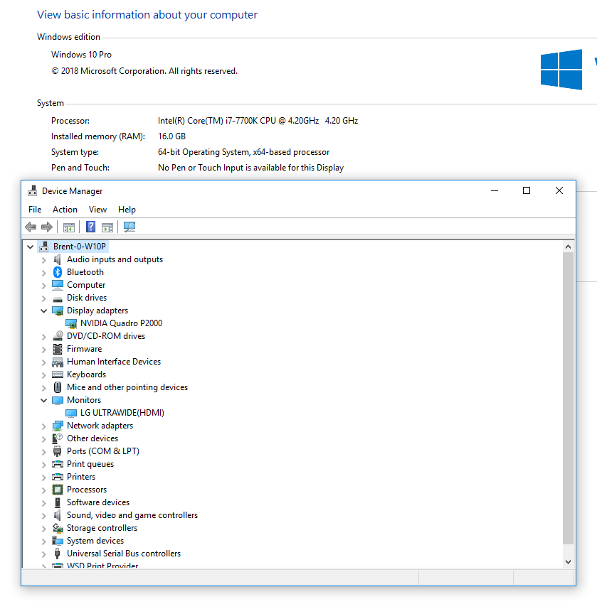

Yes it does work with less holes. The other part of this job has 458 holes and it takes about 10 minutes but it finally lets me post. I have a pretty strong computer as you can see from the attached pic. Is there anything i can do about this cause 90% of my drilling jobs will be that many holes?

What value are you setting the peck depth to? To drill without pecking set the peck depth to equal or greather than the drill depth. If you set the peck depth to 0 it will take a very long time to generate the tool paths and maybe cause it to crash as you are generating tens of thousands of pecks per hole as it tries to drill the hole with tiny pecks.
Oh ok. My misunderstanding. I thought that the peck would be 0 if i didn’t want to peck but it needs to be the same so it really makes one peck at my total depth. Sorry for that.
