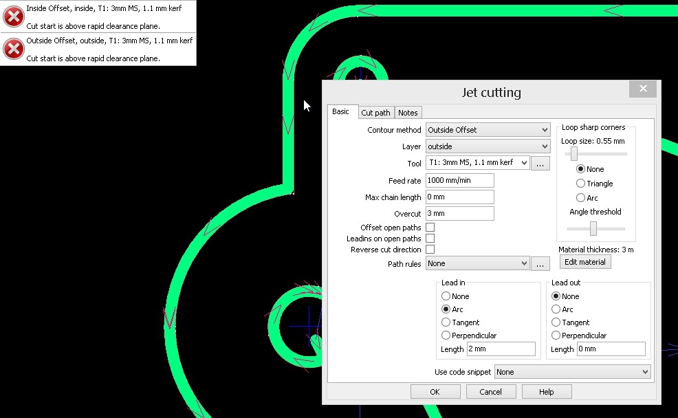

Need a bit of help guys.
I have an error message appear after doing a process and don’t understand how to fix it.
When I hover over the error message it says to double click and fix the problem.
I do that and can’t see where the problem is to fix.
The message shows, “Start cut is above rapid clearance plain”
Thanks.
Check your rapid clearance setting. I think it’s in job options. And your cut height in the tool settings. It looks like your rapid clearance is set lower than your cut height.
Thanks for that. For some reason, all my settings in application settings were changed to zero, after resetting them again all is working fine.
