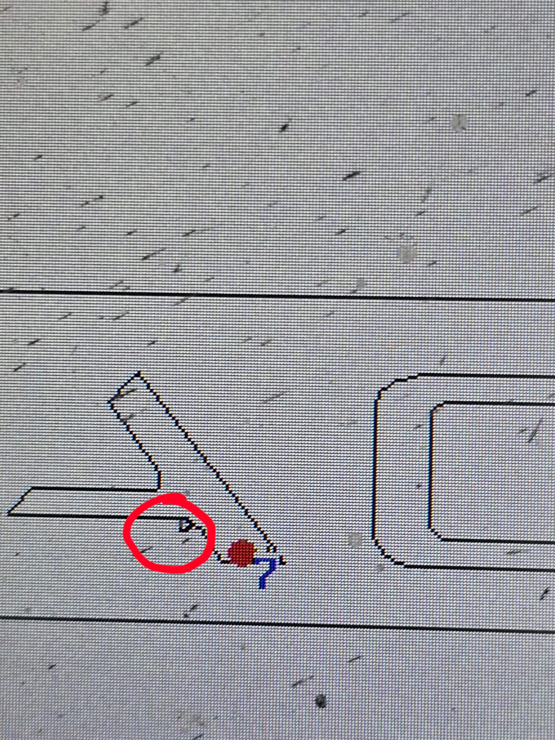

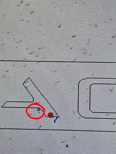

I have a strange issue that seems random. When I generate a cut path in Sheetcam I always take a zoomed in look after I run the PP. My cut paths look good. So I will save it to my thumbdrive. I have to change the file extension from ‘.tap” to “.cnc” so the table will read the file. When I open the file on the table console there are little deviations in the cut path that show up in random places. These deviations look like a little divot off of the cut path. Maybe a better term is a little notch in the cut path. The cut path is still there, but there is an additional little spot that is the size of the kerf.

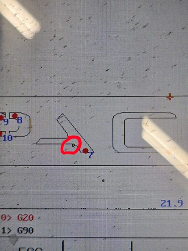

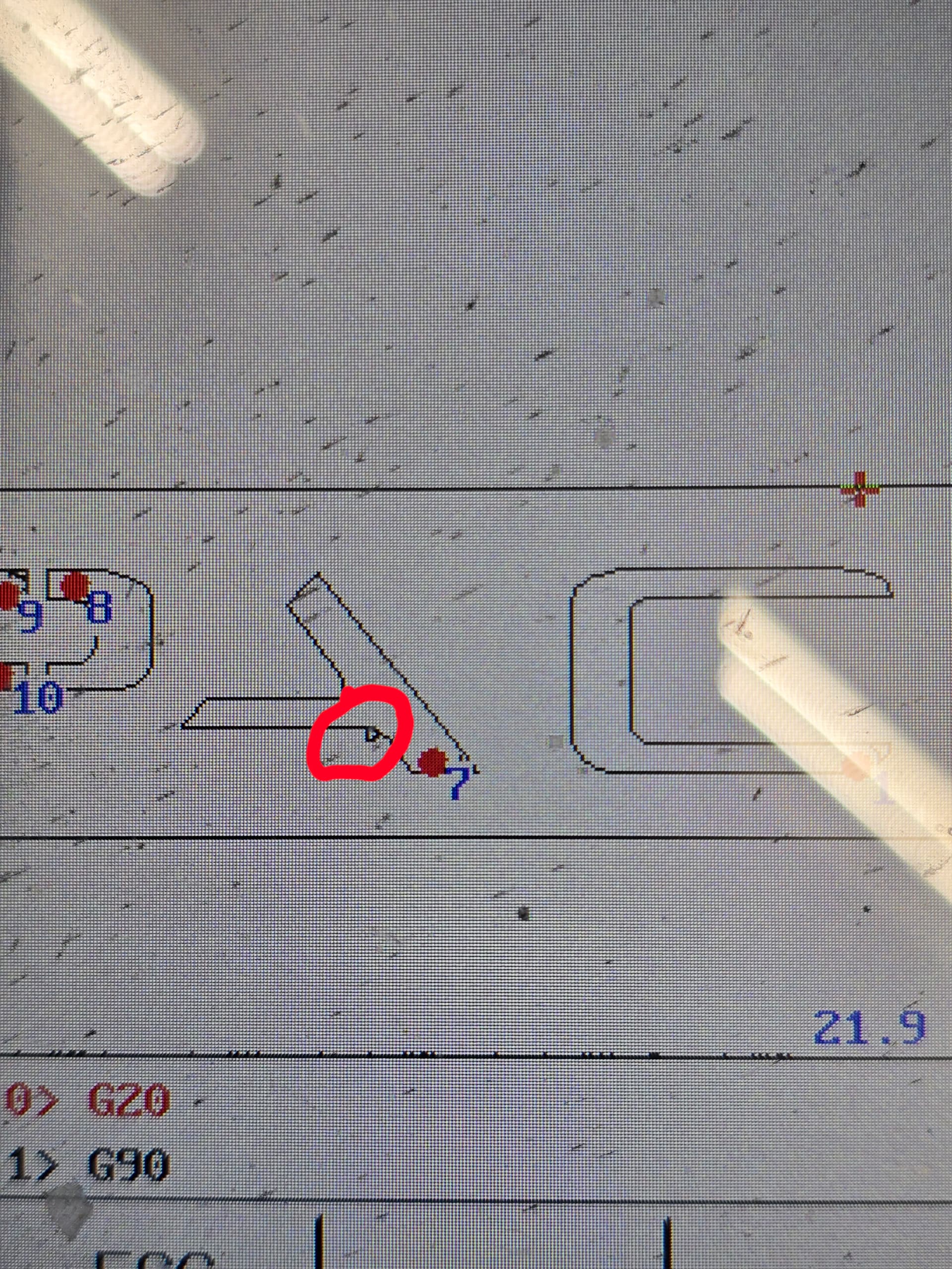

After I noticed it on a few pieces, I zoomed in on the image on the machine screen and sure enough, there is a little notch or spot where the cut line moves off then right back to the original line. I have no idea why this is happening. It is random and not consistent and it does not happen every time. I need to see if anyone else has experienced this.

After reviewing your support.zip file, the problem is in your pp, you’re using ‘cutter compensation’ G41 gcode, and your controller has a setting for the compensation amount which is causing the toolpath to jog off the contour path. You should always run G40 gcode which is ‘no cutter compensation’ mode. Then it doesn’t matter that your controller has a cutter comp offset value. Sheetcam fully accounts for the kerf width by the definition of such in the Plasma Tool.
Here’s a snip from your gcode file showing G41 active while cutting…
