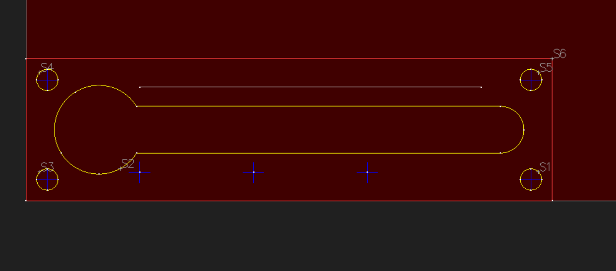

I see why what i was trying to do isn’t working now. entityClosed isn’t updating. Or at least its staying False. There should only be one open entity on this part and the rest should be closed, am i wrong in my understanding? Well, the drill points may count as an open entity also, but that wont matter.
Do you have a leadin or leadout? Any path with leads will be considered open.

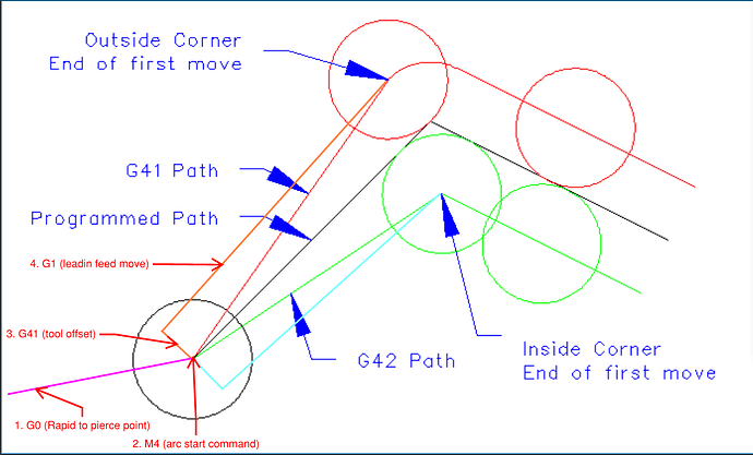

I found out what the problem was that i ran into now. I never found any issue with the functions themselves working as expected. The problem i ran into was OnPenDown is called BEFORE OnOffset. When this happens and OnPenDown is used to start the plasma arc, the arc is started, then the offset (G41/G42) gets applied and the leadin has a dog leg in it. This causes a problem with tight nests and wide kerfs.
I remember talking about this now and you pointed out some logic as to why OnPenDown is called first. Id be scared to ask you to change that now, as i am sure some have made posts that rely on this sequence and it would catch them off guard and scrap parts.

Yes, that is correct. Rapid moves do not normally have G41/G42 applied (many controls won’t let you) so the start of a cut is as follows:
Rapid to pierce point (G40)
Pierce
Lead in while applying G41/G42.
Start cut.
This link shows an example of what happens http://linuxcnc.org/docs/2.6/html/gcode/tool_compensation.html#sec:cutter-compensation
If you use a straight lead in, the lead in will be at a slightly different angle. Depending on the control an arc leadin will produce a dogleg, a disorted arc or an error message.
To get the pierce point in the exact place shown in SheetCam you would need a short tangential ‘pre-leadin’ move to let G41/G42 sort itself out.
This is just one of the many interesting quirks of using G41/G42 offsets that are handled differently by different controls.
Our plasma operates even differently from that. It looks a block or two ahead to see whats coming. Now i need to test with our waterjet and laser to see how they behave. For the plasma:
G0 (rapid to pierce point)
G41 (tool offset, head moves perpendicular to cut path in the next block)
M04 (arc start sequence)
G1 (leadin feed move acts just as if G40 is active)
If M4 is placed before G41, the picture below shows what is cut.
