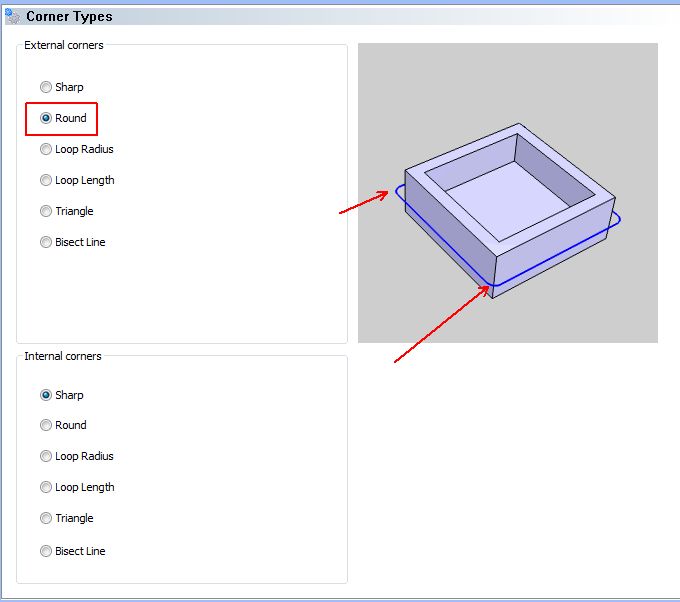

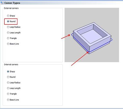

Basically, old-CAM would let us cut sharp corners, turn on corner loops (much like SheetCAM), or it will also auto-round (radius, fillet, etc) corners. The auto radius is based on tool radius - after a while I realized I could lie to it about tool diameter (since we’re running G42), and not have to manually round corners in CAD. I looked at SheetCam’s “loop sharp corners” and “arc” and my SMRT brain went “hot dog, maybe they can get them arc corners runnin too, woo hoo”. :laughing: This is what I get for trying to do 2 things at 1 time :thinking:
I mean, auto rounding corners with user-defined radius is still a cool feature for guys with lasers (especially the CC running G42 weirdos), but I bet it’s not the low hanging fruit my CAD-addled brain was thinking either, haha.
That’s an interesting feature suggestion. This is more in the category of the Overcut internal corners’ feature in sheetcam, where the part contour is purposely interfered by the cutting tool. Those may be the only cases of such programmed contour interference in sheetcam that I can think of.
