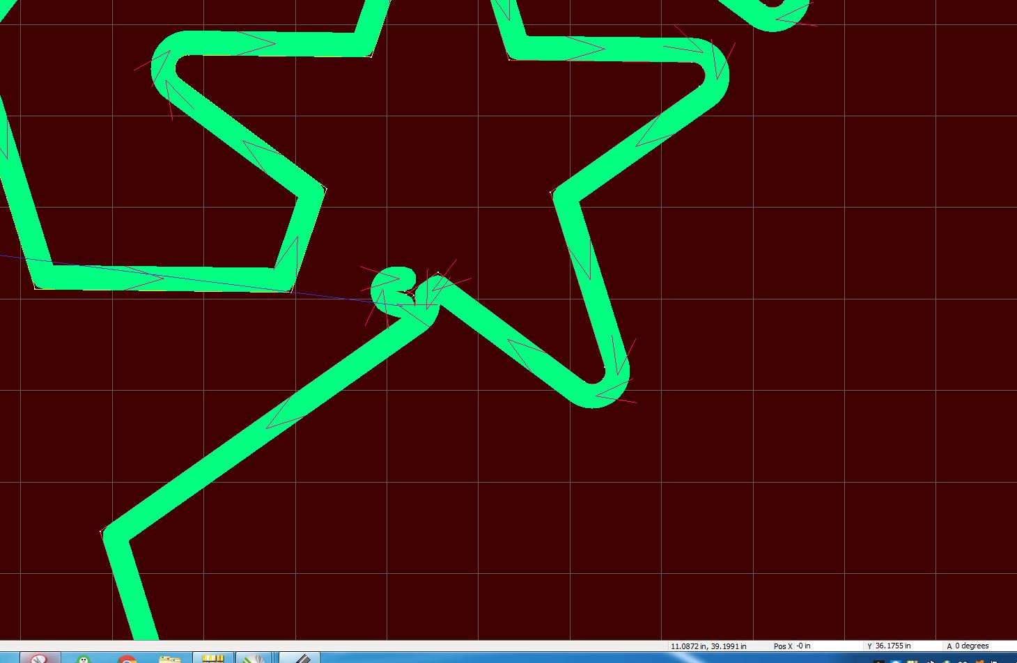

I’ve been having issues with Sheetcam creating loops/overlaps on imported drawings. I create drawings in Corel 2017, join curves, reduce nodes, make sure paths are closed, etc. The drawings look fine in Corel. Still, sometimes Sheetcam will create overlaps on corners, etc. I can play with some of the settings in the “Drawing Import” tab, and it will help with some of these issues. That is expected, as that is part of the issue Sheetcam has to deal with is dxf export from a variety of sources.

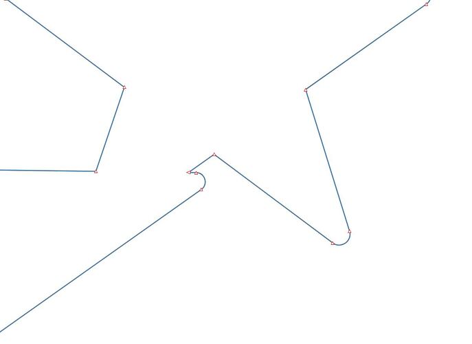

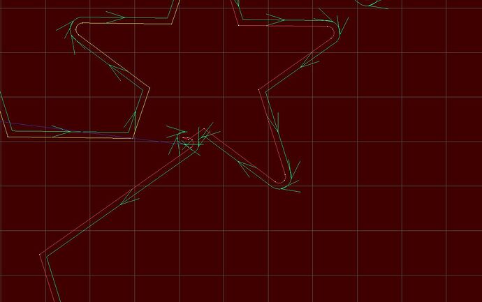

Here’s an example. The “loop” is created in the lower right hand quadrant, immediately to the right of pierce point S20. I’ve attached a copy of the SVG file as well. Looking at the SVG file in Corel, there is no issue at that point. There are a couple of nodes close together (about .020"), but no overlap, no loops, lines are connected, etc. Sheetcam appears to be creating the loop in this instance. I’ve attached a screen shot of the area in Corel, so youc an see the nodes in question.

I opened your .svg file with my version of CorelDraw, and that loop was in the .svg file you posted. Have you tried opening the .svg file with CorelDraw after you’ve exported it from CorelDraw ?

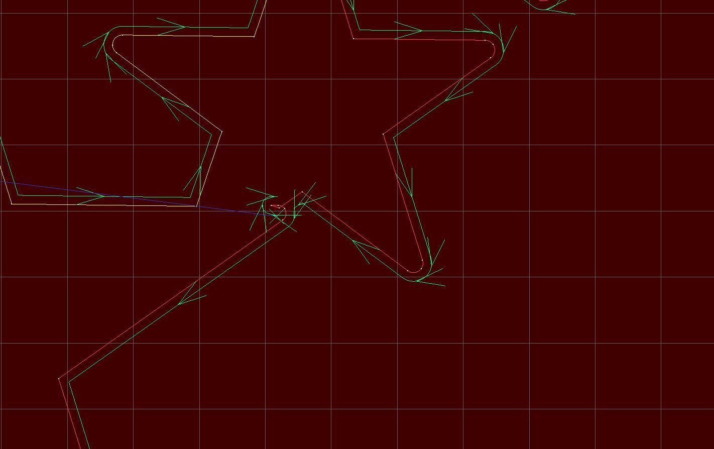

I went thru your .svg file and cleaned up a few spots I found with problems. I won’t swear that I got them all, but see if this file works better for you.

Yes, I re-opened both the .cdr and the .svg file, and it’s clean in both of them.
I ran into the issue again today, and was able to see what WyoGreen saw. File looks great as a native .cdr file, but will export with small errors when I save it as an .svg. Using Corel2017. Odd.
From what I’ve been able to tell, it has to do with how close nodes are in the drawing. When I have a Corel drawing with a couple of very close nodes, I get this issue. I’ve been trying to remove “very close” nodes in my drawings in Corel, and it seems to have fixed the issue.
