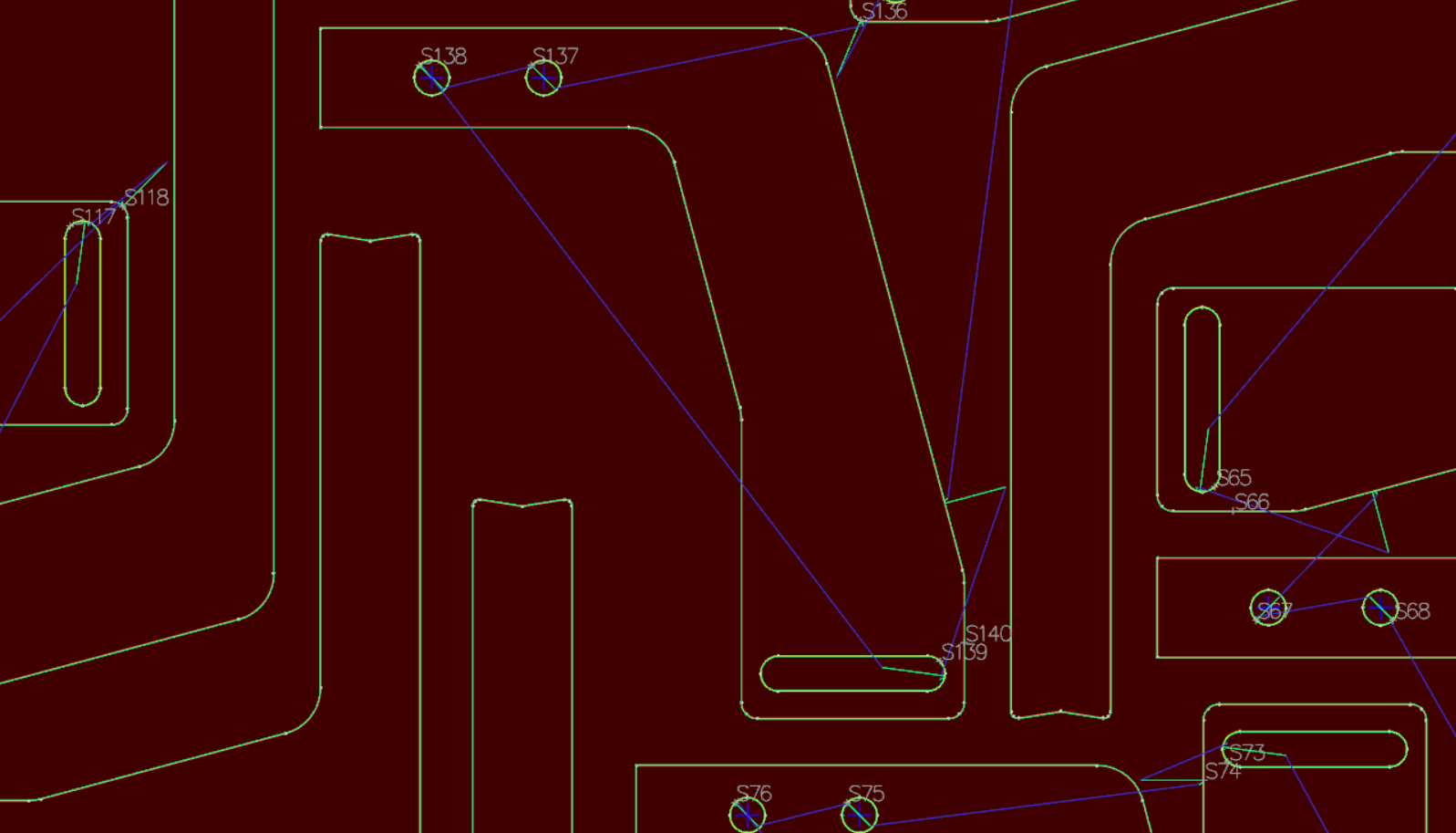

And while we’re in the options dialog… The start point tool clearance seems to do nothing for the jet operations. No matter what i set it on, it still places it wherever and even sometimes places it into other parts. i thought setting it on 200% should place it with the tip of the leadin at least the distance of the leadin away from another part, but it doesn’t.
This only has an effect if there is not much room for the leadin. This value controls the minimum distance between the pierce point and any other nearby cut paths. However it only works with the current operation. It does not look at other operations or other parts.
Yeah, its doing absolutely nothing for me. Same part, same operation, and the start points are nearly touching other cut paths. (See attached)
