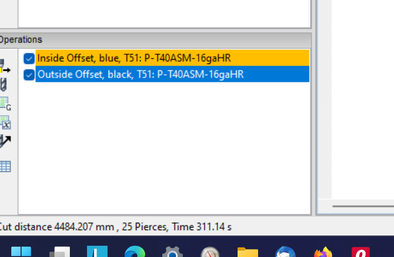

Is it possible to determine the total length of a plasma cut in Sheetcam; whether it consisits of a single piercing and cut (e.g. cutting out a rectangle), or multiple piercings and cuts?

yes, if you select any Operation, then all checked Operations will report the cumulative cut distance, pierce count, and run time in the bottom left corner of the main SC window. See the photo.
You can also run a Report to get even more stats on the job.
Thank you very much bLouChip, that helps a lot.
