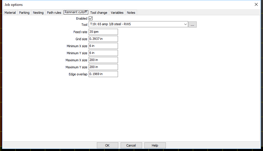

I know that sheetcam supports that function, but is there a way to create a cut line manually in sheetcam? Like select a line tool, click where I want to start and stop and make like a poly line, then have the machine cut that at the end of a job?
Richard
SheetCam doesn’t have any built in drawing functionality. There is the move operation but it would be a bit clunky to use. You would need one move to the start of the cut and another to do the cut.

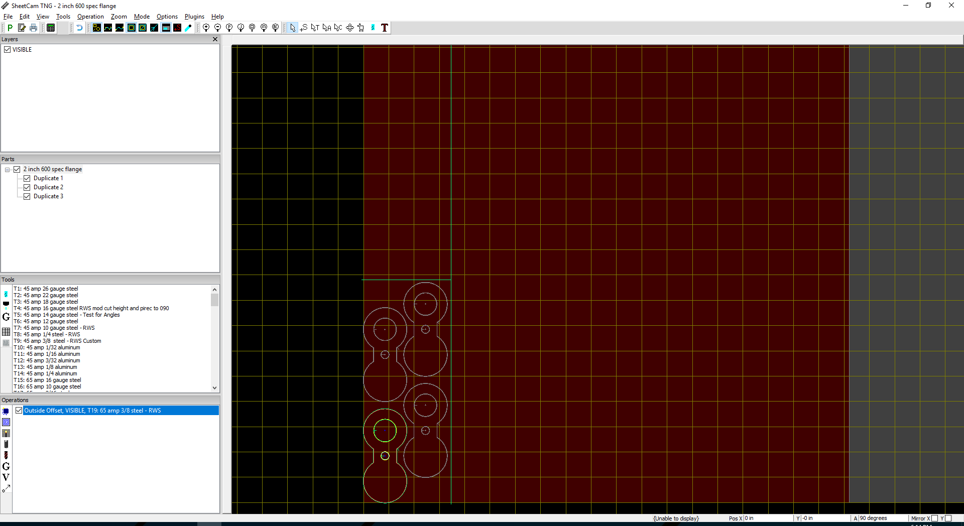

Below, I would like to cut out the bottom left corner and leave the rest of the sheet untouched.
So how do I keep the Y from cutting the entire sheet vertically?
There isn’t really an option to do this. One option would be to do it in your drawing.
