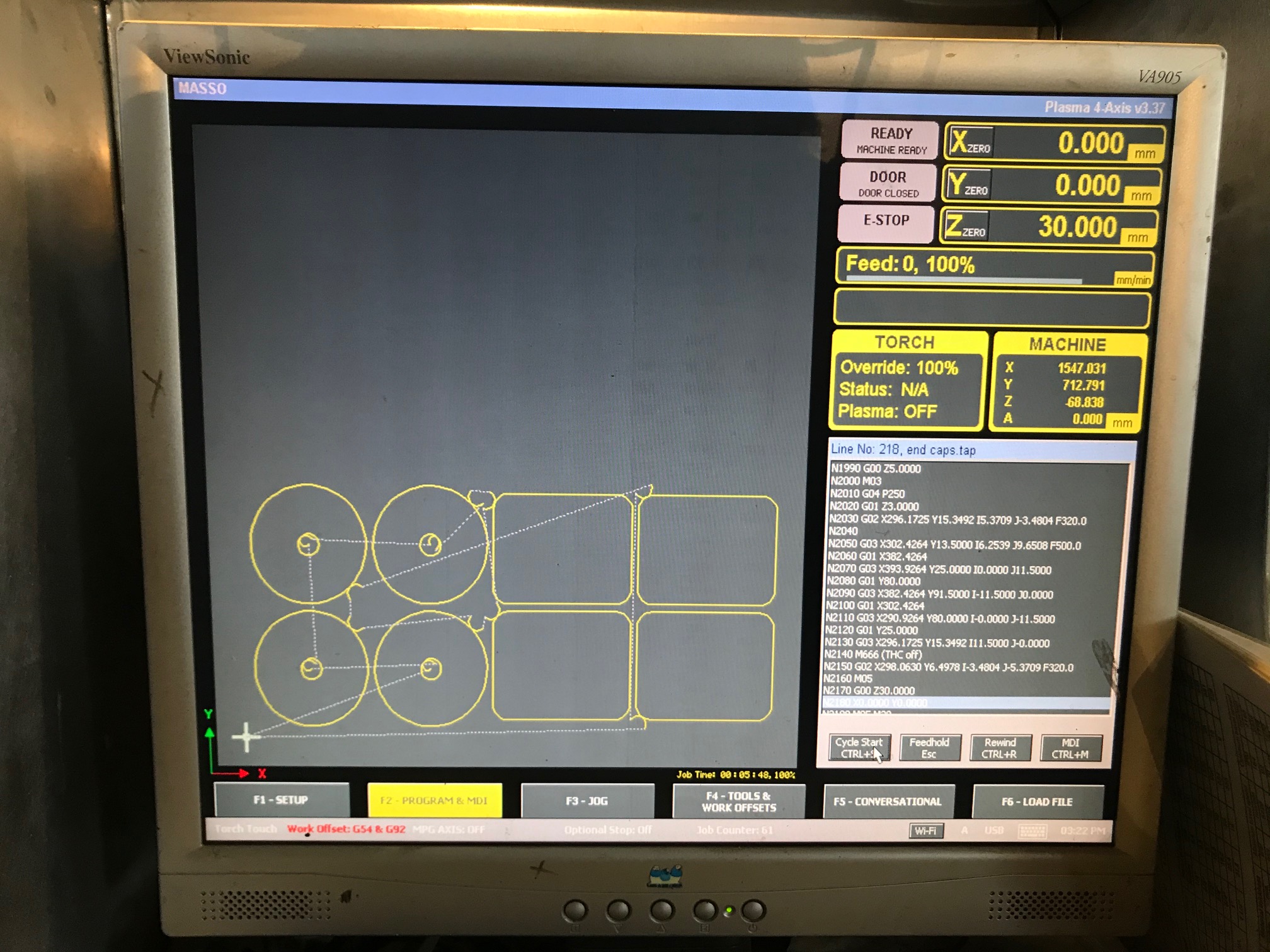

I have a CNC plasma using a Masso and Sheetcam. Using the Masso post processor, which has been working well up until now.
When cutting circles it seems to be a bit hit and miss.
Running the simulation in Sheetcam - Seems fine.
Loaded on the Masso display screen - Seems fine.

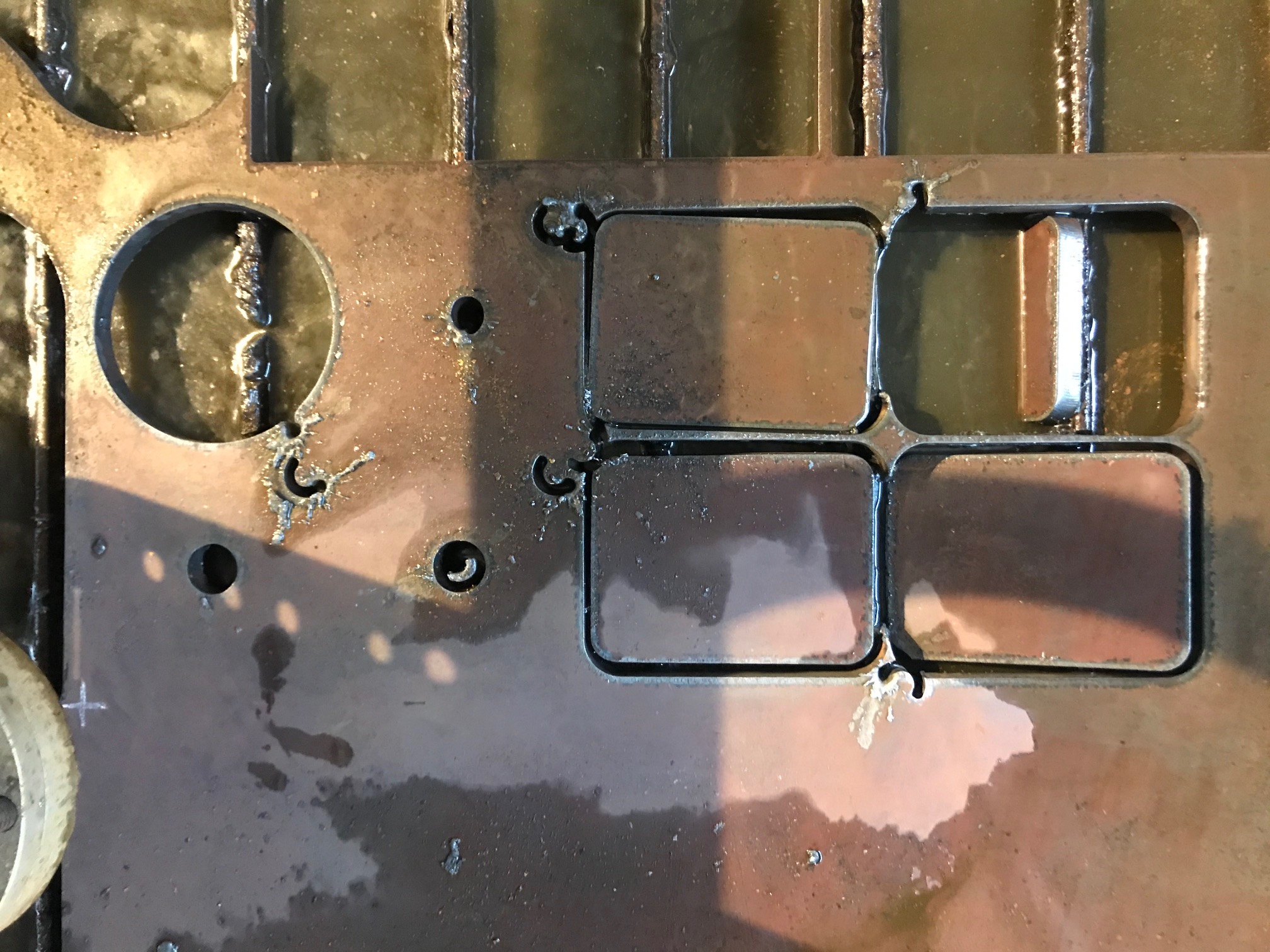

Actual cut - Only cuts the lead in and lead out, no circle?

The one above is the only one that worked. Yet the following below didn’t. The only difference I can see is the ‘-’ following the ‘I’?

Normally arcs in g-code are specified with the start coordinate (the current position), the end coordinate and the arc center. Circles are an oddity. They are an arc where the start and end are the same. It looks like there is a bug in the Masso controller where it sometimes interprets this as an arc of zero size instead of a circle. The extra code I asked you to add makes sure arcs don’t exceed 90 degrees, so a circle becomes four equal arcs. I will add it to all of the Masso posts supplied with SheetCam.

I have run the endcaps.tap file you provided on the current software version and it is running correctly.
The machine cuts the circles and the rest of the file as it should.
It looks like your guess about the software version you are running being out of date is the problem.
Now that you have a work around for the small circles the main advantage you will get from updating is the little hesitation that occurs when you turn the THC on and off will no longer occur.
The current version is 3.49 for the MASSO G2 and you can download it from your myWorkshop portal. https://docs.masso.com.au/my-workshop
