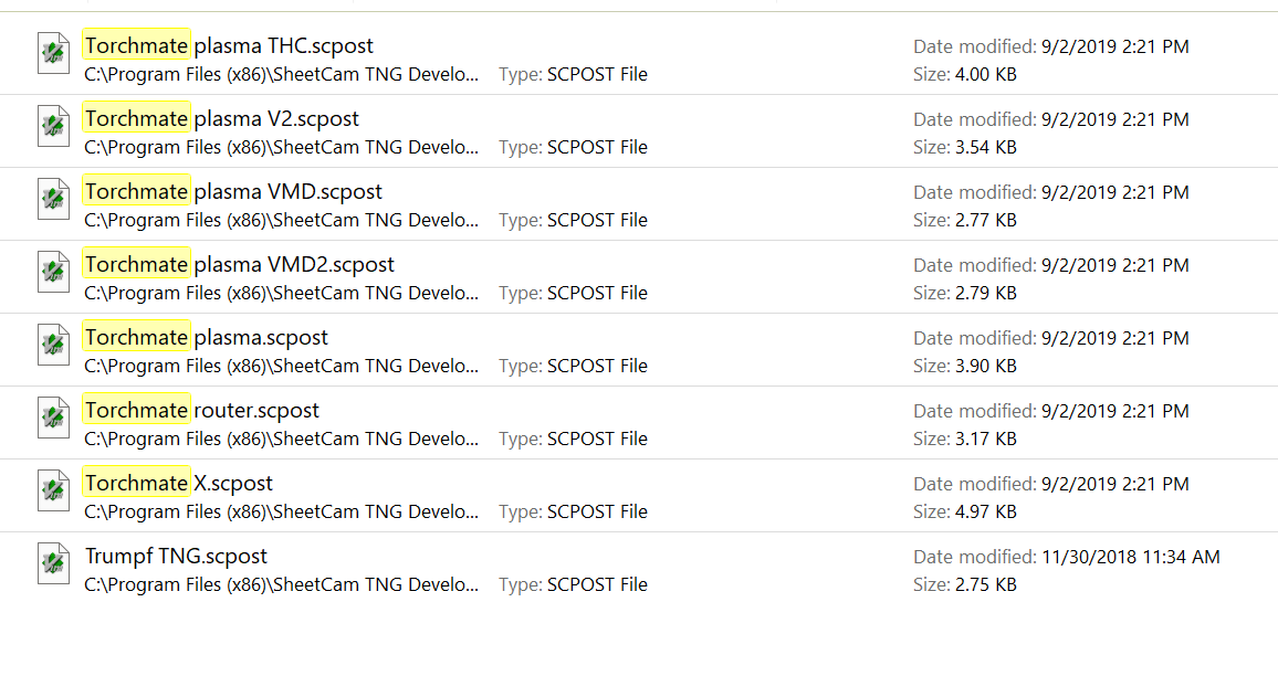

Sorry to resurrect such an old thread, but any chance of getting this post processor reposted? I’m setting up a plasma table with torchmate Accumove 2 control (which uses pretty much the same Gcode as the AM3). It seems that the post attachment may have been removed since this thread is so old.
Thanks~
There are several Torchmate flavor post processors in our TNG Sheetcam Development version install folder. Install the product and use it free without license until you’re satisfied you like it. Limiting terms apply to gcode file size, 180 line limit in free use mode.
