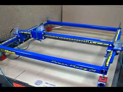

Hey everyone, so i bought used setup and the old owner had people make his g code etc, I’m trying to follow the online you tube videos , but when i save from sheet cam the mach 3 only shows abut 5 lines of code, any suggestions? looks like the old computer he gave me runs - inkscape - sheet cam -mach3

A little more information will help us help you. What brand CNC table? What post processor are you using in Sheetcam?

EZXYCNC , the post processor thing I’m kinda stuck on i tried it with mach3 it will run of a hypertherm 45xp.
So it’s a cnc plasma table.
Does it have a floating head for the torch.
Can you succesfully import an SVG file from Inkscape into Sheetcam.
If so, send a Sheetcam job file here, showing the tool selected, completed operation, etc. I.E. a job file ready to generate the gcode (= run the post processor).
I can then easily choose a post processor and send the generated gcode back to you. You can then try it out on your plasma table and see if it works.
Do you see any green tool paths? If you do it sounds like a license issue. If not you probably haven’t created any operations or your operation(s) are on the wrong layers.
As for the post processor I assume you are using Mach3. In that case use the ‘Mach3 plasma’ post to get things working. This is the simplest and doesn’t have the extra complexity of a THC touch-off.
yes i am seeing the green tool paths. i will use mach 3 , would the version of programs be a problem and the windows is windows xp 2004

Anyway you’ve told me you have no THC, but does your Z have a floating head to touch off on the surface of the metal before each pierce. Or is your Z just a simple direct driven one with no floating head. Or do you not even have a motor on your Z axis and thus your system is purely a 2D XY axis controlled setup. All of these factors affect what post processor you’ll need to generate the gcode.
XP is fine. It sounds like a license issue to me. Even if you have the wrong post processor you should see more code that you are getting.

Oh and yes i have a fixed mount for torch no height control 2 axis unit 2 motors thats all
this is off the company website mines just like that one in pic 3 motors my mistake.
OK, based on the information I have from you, all I can suggest is using the following post processor:
Mach3 plasma no Z
Your table appears to have two X axis motors, one Y axis motor, and you simple mount the torch on the Y axis plate, i.e. no up/down control.
I generated gcode in Sheetcam using that post processor and it seemed to give out the right type of code for your design of table.

That’s a pirated license and it won’t work any more.
