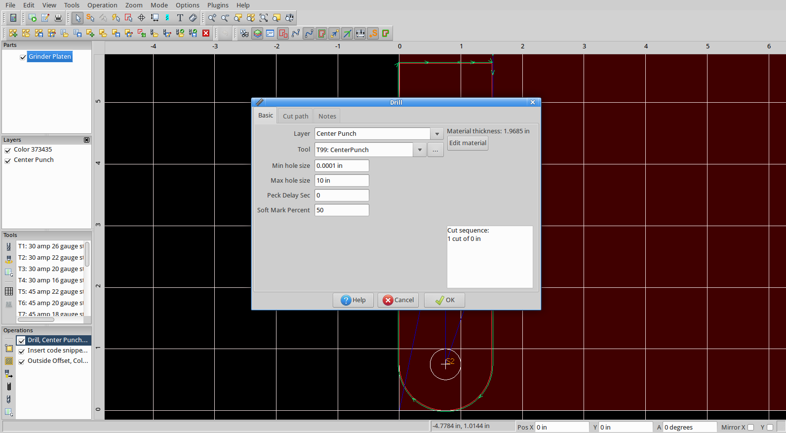

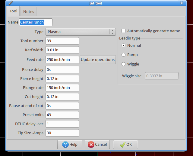

I just did this a few weeks ago on my CandCNC (CommandCNC) system, so I know it works. I did it with the CandCNC rev27 post. I use a HT45 Plasma cutter and turned down the amperage to 30 amps to mark the holes, then back to 45 amps to cut the part out. I put a pause in the job to turn the amps back up (don’t know if that was really necessary, but I did it anyway.) I took a couple of screenshots to show my settings. Hope this helps some.
Steve

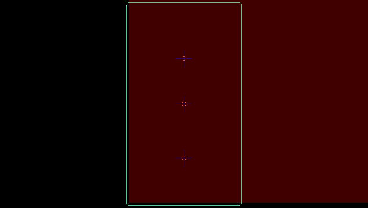

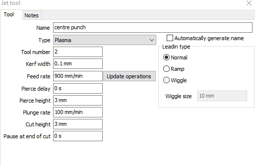

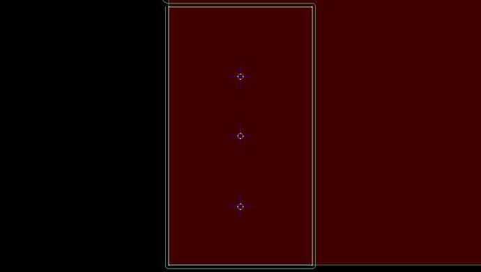

I have the original job file that I used (attached) and also have the DXF
centre punch test.job (6.26 KB)
I can’t see anything wrong with the job file. The center drilling looks correct. Could you let me have a copy of your post processor.

I just ran your job with that post and it appeared to work. One thing I noticed is that your ‘centre punch’ tool has a pierce delay of 0. If you have arc sensing this is fine but if you don’t, the torch probably won’t fire.
I probably don’t have arc sensing, so what should I do?
When I run the file, the torch goes through all the motions correctly, just doesn’t fire when it is supposed to do, then moves on to the next hole and misfires again and so on.
What cutter are you using? The arc sensing he is referring to would be an arc ok signal from the cutter to let the program know that the plasma arc has transferred and it is cutting. If you don’t have this signal you need to add time to your pierce delay to allow the arc to begin cutting before it begins movement. I would think a second would be a good start.
The cutter I am using is suppose to be for hand held use only, it has no special features except it has low frequency pilot arc.
Unimig Viper 30
It is only a 30 amp machine, but works very well for my purposes, I use mainly 3mm (1/8") thick mild steel for most jobs.
If I add pierce delay time, what amount should I try, I have no idea?
I would start with one second and test. If it doesn’t pierce, add 1/2 second and try again. It’s going to be trial & error until you figure out what works.
