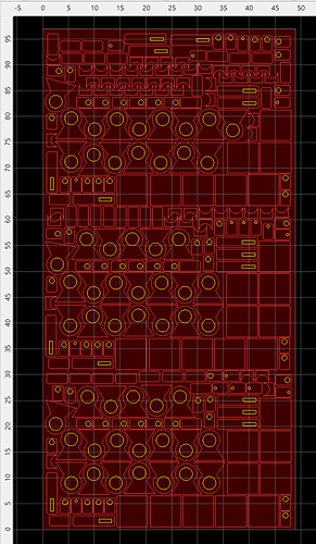

I tried loading your dxf into Lightburn (my CAD); although it did not throw an error, it only imported 4 of the shapes.

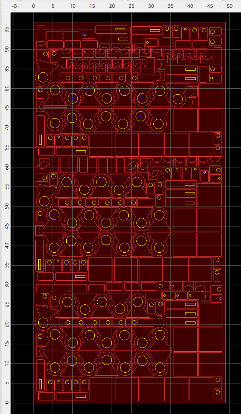

As for sheetcam, it imports your dxf as a full 4’ x 8’ sheet of nested shapes as seen here…
I assume this is correct. If so, sheetcam is operating fine. Consider asking your question on the CAD forums that don’t correctly import your dxf.

Can you explain further how you “…nested sheet created in Sheetcam” v6.x ?
I know how to duplicate Parts, drag and arrange Parts, Array Parts, in sheetcam. But your dxf would have to be a mish-mash of all the above, a lot of manual Part arranging and partial Array building. There does seem to be a 2x pattern of a block of shapes in the bottom 2/3rds of your sheet, and the top 1/3rd is somewhat of a hacked copy of that block as well. Is that right ?

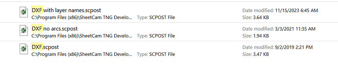

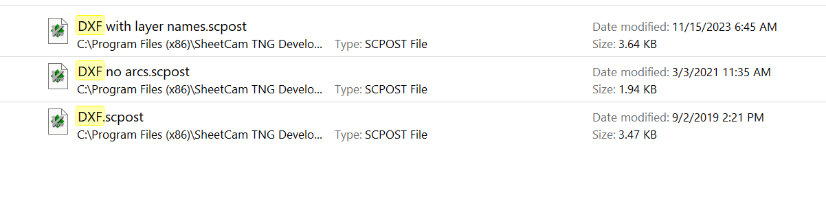

I think I found the pps in the sheetcam install pp folder…
are these correct ?
Hey there. I only have the last one in your list due to the old version of SC that I’m running.
Re. The nesting, actually just manual part duplication and manipulation, not true “nesting” and yes a hacked copy as you surmised.
