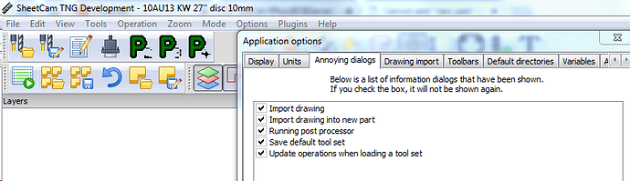

In one of the options under the menu it has a box that shows the annoying dialogs that you said you don’t want to see. You should be able to clear it from there. Sorry to be so vague on the location. I’m at work and SheetCam is at home. If you can’t find it, I’ll post back when I get home.
