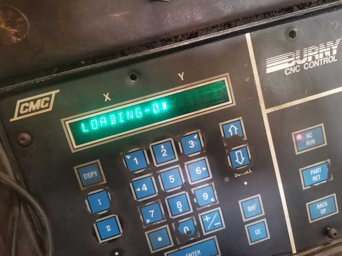

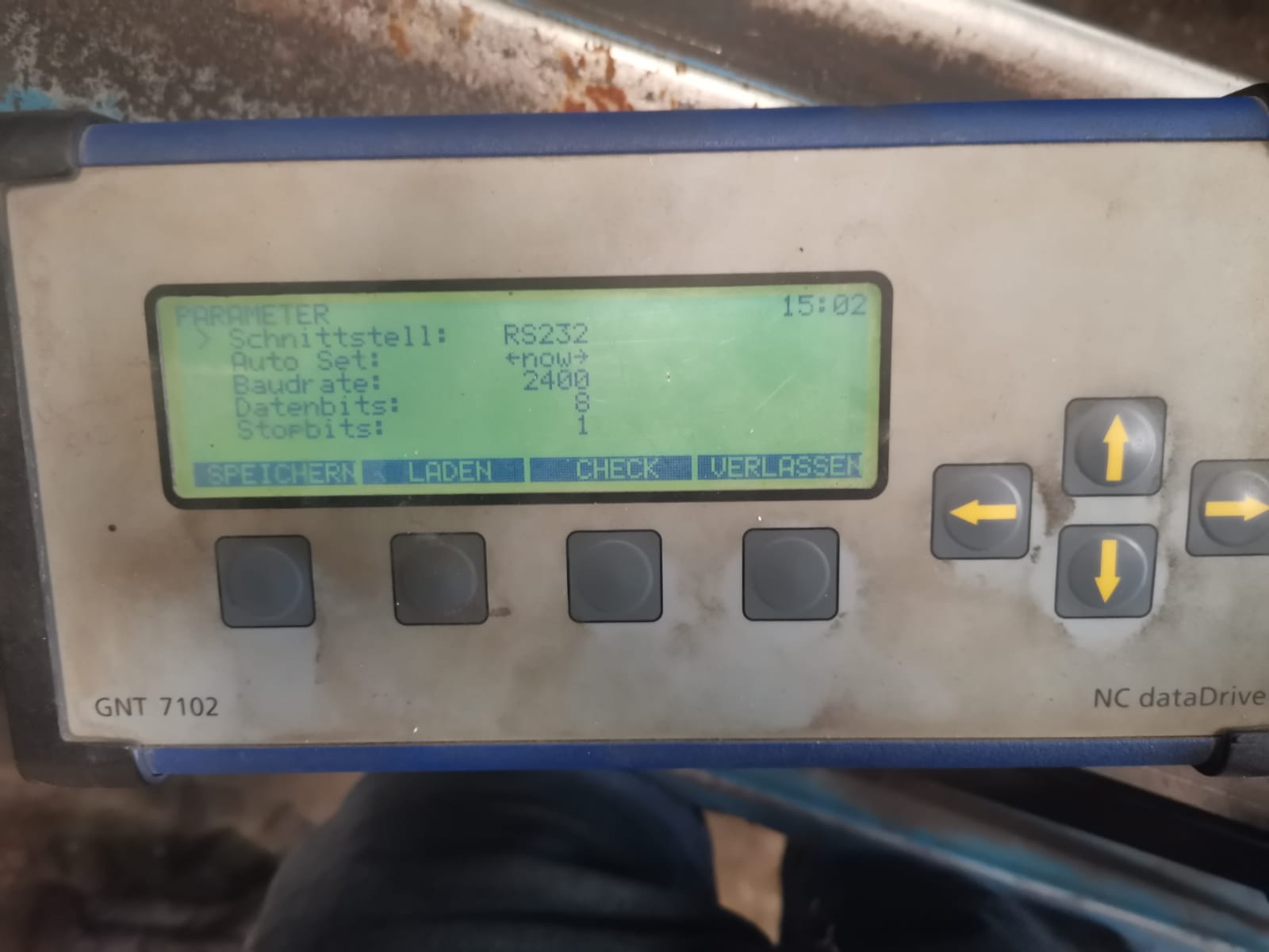

I want to set system data variable for Burny 5 and 2.5 to transmit Essi program via PC or GNT 7102 Device

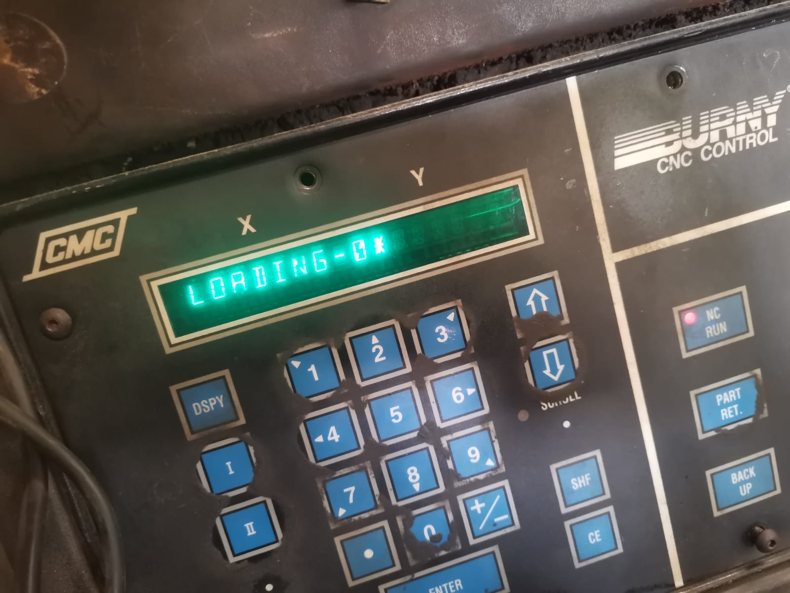

in the Burny 2.5 i was replac the battery and reset the system
i set serial definition SD50= 1725 NP8d
and the SD51 = 0010100
when download files from GNT7102 the Burny write " Loading 0% " without complete as per attached picture.
how i can fixed this problem.

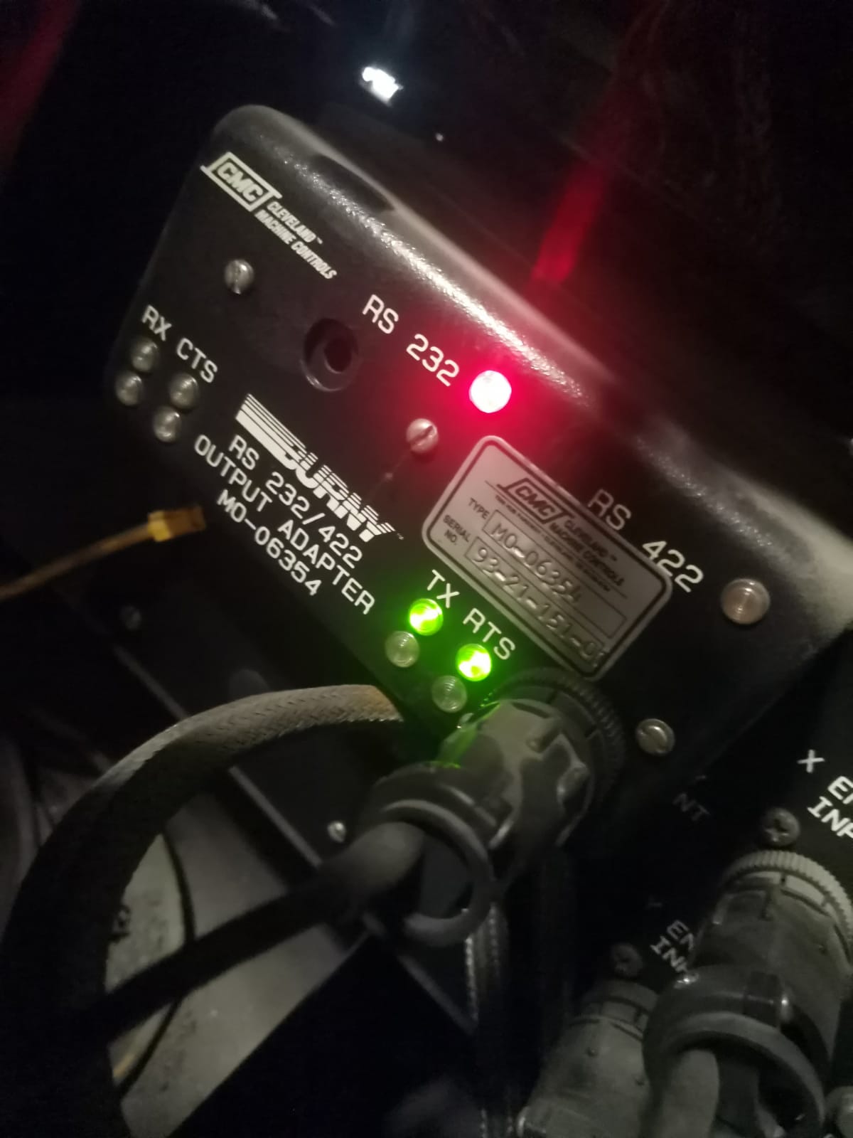

in Burny 5 i set 41,42,43 variable to 4161
and the comlink variable to 033161
i am using DNC software when i transmit data via pc the burny write “Calling :” without showing any errors
